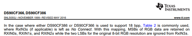

  • Hi Horst,
    I'm not fully following the difference between the two - the order between Figure 8 and Figure 9 does not look to be transposed. Could you possibly clarify?
    For more details regarding bit mapping, please refer to "Section 8.2.2.3 - Data Mapping between Receive and Endpoint Panel Display."
    Nikolas

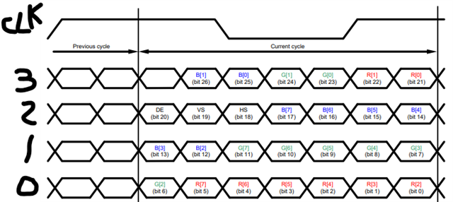

  • Hi Horst,
    I see the confusion now - the two devices have two separate bit mappings. For added context, please refer to the following statement from the data sheet:
    The reason why RxOUT# is not perfectly sequential in Figure 8 is because for DS90CF386 RGB666 applications, the LSBs for each color are placed on RxIN3 so that they are easier to be left as NC (so that only one LVDS input channel that houses all three LSBs needs to be left as NC instead of one stream position across three separate LVDS input channels). See the following timing diagram with MAPSEL = L for details (note that this is from a 92x data sheet, but the same principles apply):
    For Figure 9 and DS90CF366 RGB666 applications, RxIN3 does not exist, so therefore the RxOUT# pins are mapped sequentially. See below timing diagram with MAPSEL = L (again, note that this is from a separate data sheet but the same principles apply):
    It also looks like Table 2 and 3 for DS90CF386 slightly groups RxIN# and RxOUT# incorrectly. Please note that each RxIN# should correspond with 7 RxOUT#s.
