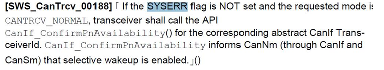

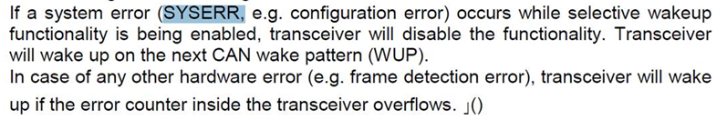

3. Could you please explain what register corresponds to SYSERR in the Autosar specification?
  • Regarding SYSERR, the AUTOSAR CanTransceiver specification is as follows.
  • SYSERR is written abstractly, as shown in the example, and is described as a configuration error.
SYSERR is determined when the SWERR flag in the INT_3 register is set. I'd like to inquire whether the SYSERR in the AUTOSAR specification above could refer to the SWERR flag for the TCAN1145.

    3.It seems to be best implemented by monitoring / clearing the SWERR bit. I.e. SYSERR is defined as a generic level error - OR-ed into the SWERR bit of INT_3 and should map SWERR to SYSERR status, thanks.
