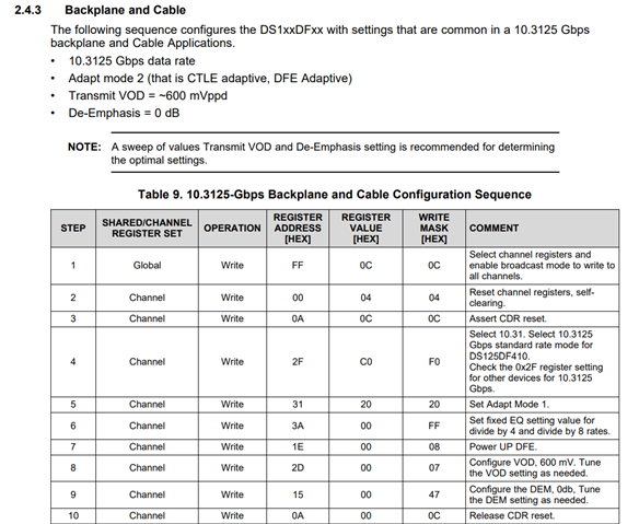

当使用器件时,配置12.5G的二分频去重定时6.25Gbps的数据时,将管脚ADDR0/LOCK作为CDR状态检测的管脚,按照手册说明,当CDR锁定时该管脚将输出高电平。但是在使用时,发现该管脚始终为低电平,只有当把器件连接到Sigcon GUI并且打开state monitor连续更新状态后,CDR才显示锁定并将该管脚输出为高电平。并且当输入信号断掉再重新给retimer 之后,CDR无法锁定,同样是必须打开monitor持续update后才能锁定。想请问这个问题如何解决?
    Have you configured the retimer?
    The below is from the programming guide:

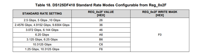

    Please replace the 0x2F register to 0xA6 for 6.25Gbps:
    Sigcon GUI may be configuring some registers internally when the initial connection is made to the device, especially to release the CDR reset, so please try running a initial configuration to see if it locks.
