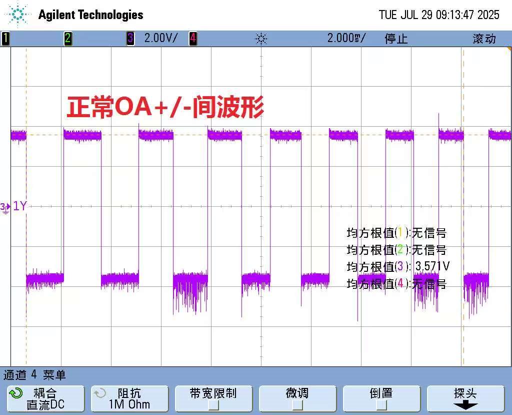

Above is nornal differential siganl from (OA+) - (OA-)

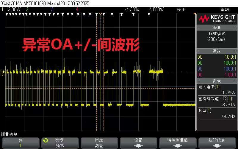

Above is issue waveform and you can see differential signal is nagetive.

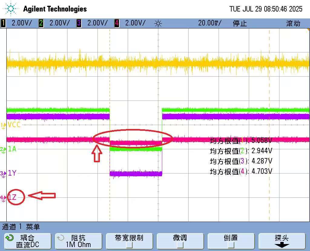

Above figure is to measure 4x signal by using single end to GND. You can see 1Z pin has a abnormal output.
It seems that 1Z can’t be pull down to GND, which means low side MOSFET is damaged or something wrong on MOSFET’s driver.

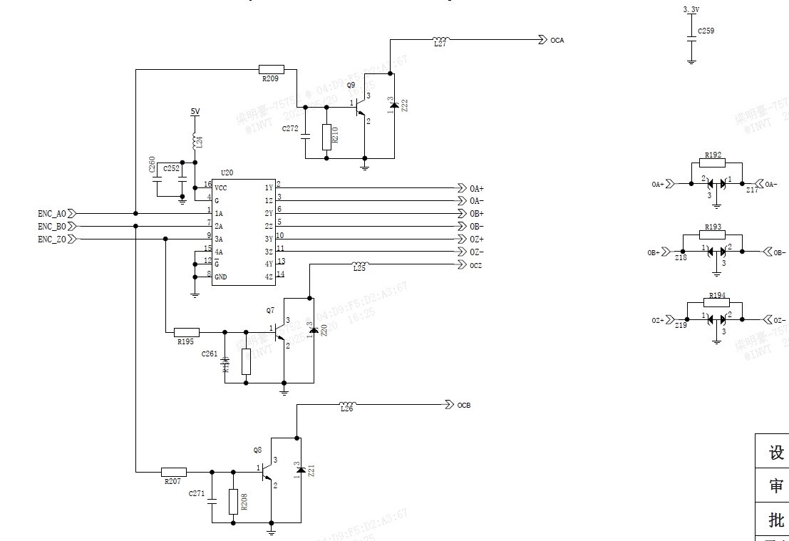

The TVS device they use between AM26C31’s output and connector is ESDA14V2L, which is 12V/12A/300W. Is it enough for this application?
Could the failure be caused by an ESD problem between those two boards.

  • The TVS device they use between AM26C31’s output and connector is ESDA14V2L, which is 12V/12A/300W. Is it enough for this application?
    Normally, it's best to use a bi-directional TVS to prevent it from forward biasing if the common mode shifts negative. But in this application and scopeshots, I don't think this is the root cause of the issue.
    It's possible damage came from a transient event like ESD. We wouldn't really be able to verify that though.

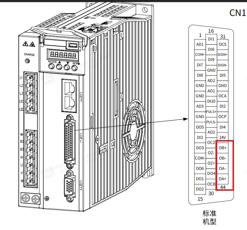

    • As you can see as below, AM26C31's output is on the right and bottom of the connector and this connector has foolproof structure so there is no possible that Y or Z pin will connect with other signal or power supply.

    I don't see any issues from the schematic point that would would the output pin like this and it looks like the customer is not using the device outside of recommend operating conditions.

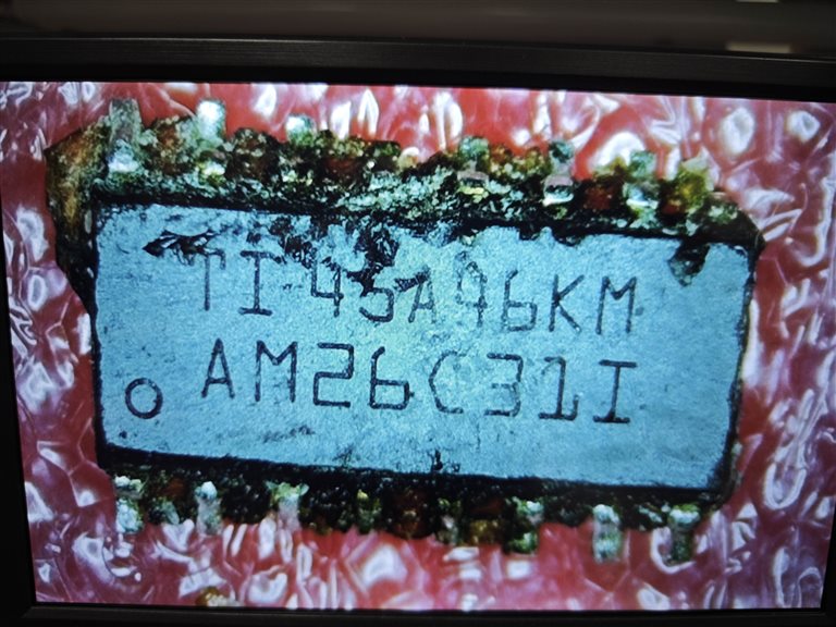

    CQE deny to do FA for my customer since issue device is obviously EOS.
    I am asking customer to reproduce the issue by plug in and out for many times and use ESD gun to damage the AM26C31.
    By the way, do you think lower break down voltage bi-directional TVS helpful for this case? Such as TVS0701 or TSD12C
  • By the way, do you think lower break down voltage bi-directional TVS helpful for this case? Such as TVS0701 or TSD12C
    If damage is due to the abs max of our device being exceeded then I believe so. The ESDA14V2Lshows it clamps at around 14.2V while our abs max on the differential pins are 14V. It would be better if you can clamp it sooner. I would also suggest using a bi-directional TVS diode and not a uni-directional.
    We can loop in the protection devices product line to suggest a TI TVS diode if you'd like.
