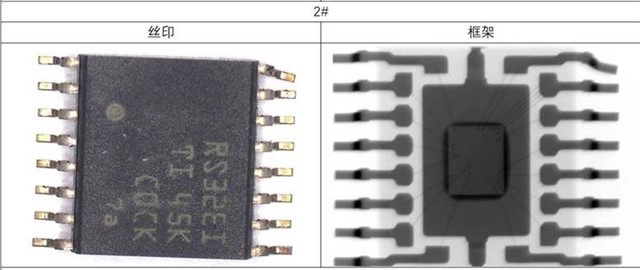

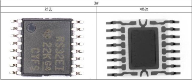

Customer feedback that TRS3232EIPWR has different size on die as the pictures below.
Below picture#1 and #2 are from RFAB, #3 is from DFAB or CFAB? Now all material are from RFAB?
Part Number: TRS3232E
https://mm.digikey.com/Volume0/opasdata/d220001/medias/docus/4890/PCN20210625000.1.pdf
New dies are from RFAB. (PCN shows fab site for new dies)
Old die (#3) could be from DL-LIN or CFAB. I can't tell since we made both dies at two different sites.
