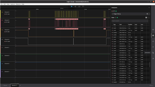

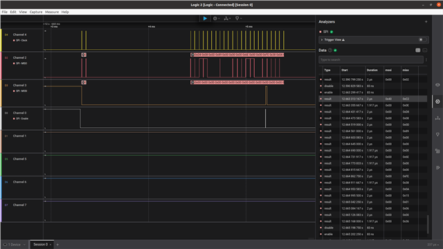

We traced the SPI communication:
  • MISO continues to provide normal output.
  • MOSI, when the CAN transmission fails, shows two different behaviors:
    • At first, it still responds normally to SPI communication — no abnormalities observed.
    • Later, even the SPI responses become abnormal, with MOSI returning 0xA0 or 0x40.
normal:
abnormal:

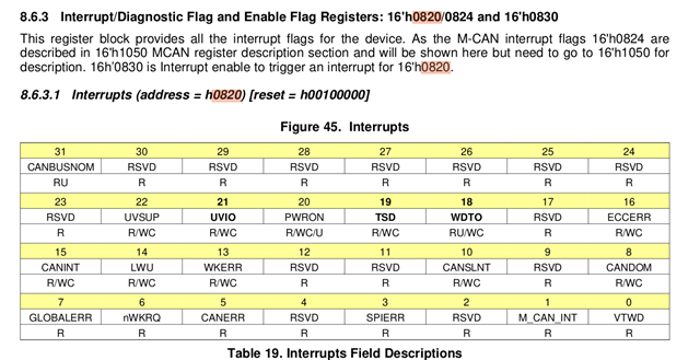

Could you also help confirm whether my interpretation of the SPI response is correct?
When decoding the response from MOSI, it appears to represent 0x0820, as shown in the image below.
From the TCAN4550 datasheet, 0xA0 indicates SPIERR | M_CAN_INT | VTWD.
Under what conditions would such a response be triggered?
  • Hello Hsinyu,
    I am unable to understand your SPI logic analyzer plots and make sense of the data.  The byte values don't make sense and I can't find the read/write Op Codes of 0x41 or 0x61 in the byte listing.  Also, the time scale does not allow me to see the individual clock and data bits, so I can't make sense of the plots.

    Generally speaking SPI Errors are related to either an error in the SPI driver creating an incorrect format of the 4 signals or an incorrect number of clock edges while Chip Select (Enable) is Low.
