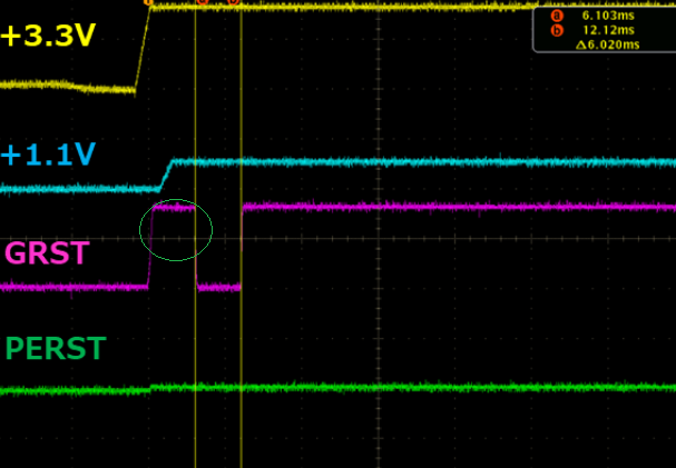

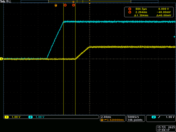

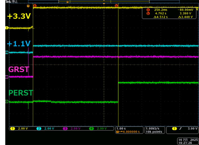

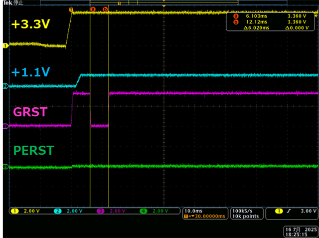

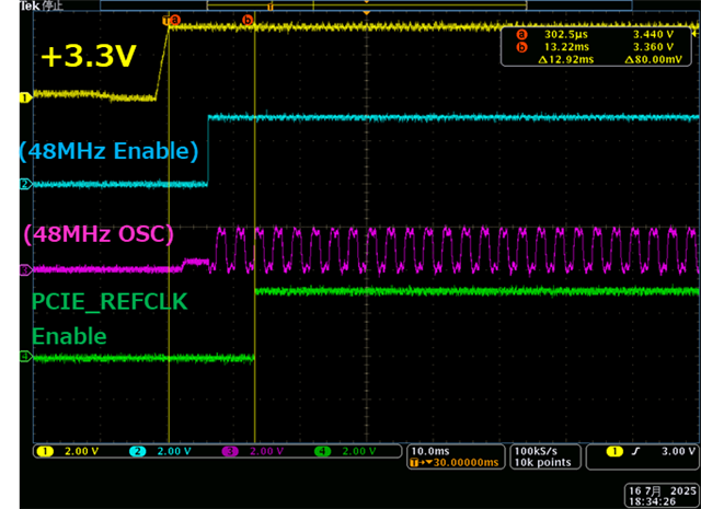

This is an inquiry regarding the startup of the TUSB7320.
We have added the constraints you previously advised, but after the TUSB7320 starts up, there is an issue where PCIe does not output.
Occurs 9 times out of 267 times.
TUSB7320: Cannot connect USB 2.0 devices(Additional question) - Interface forum - Interface - TI E2E support forums

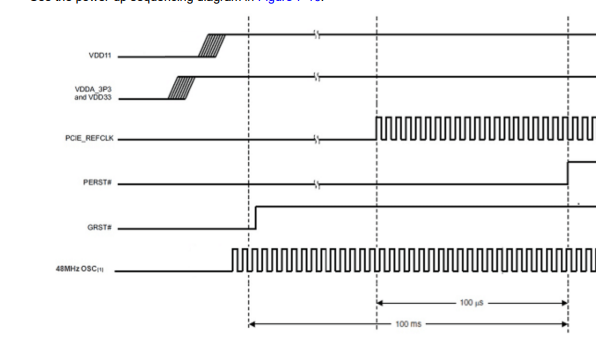

Could you please tell me what other constraints should be added besides the ones below?
•The reset period of GRST must be Min. 3ms.
•The input/output terminal for the GRST terminal is not determined until both the 3.3V and 1.1V power supplies are turned on.
•Recommend to add a capacitor ( > 0.1uF 0.1uF±20% ) on GRST to ground.
