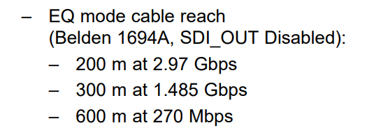

LMH0397 datasheet shows when it work as a receiver at EQ mode, cable length can reach 200m at 2.97Gbps (with Belden1694A cabel)
Refer Belden1694A datasheet,the cabel attenuation at 1.5GHz is 7.8dB/100ft (25.7dB/100m)
Q1:
Can we evaluate the LMH0397 EQ mode could work at maxium 51.4dB cable attenuation condition ?
In our project ,want to use a 20m RG179 cabel (total attenuation is 21dB) .Is it available ?
Q2:
If SDI_Out is enabled, use second 75Ω driver as loop-through output in EQ mode, how much affect on cable reach length ?
Hiram
  • Hi Hiram,
    Yes with Belden1694 we have validated the EQ is enough to compensate 200m (51.4dB). If your cable is 21dB LMH0397 should work.
    I do not see test data on this, so I recommend using the EVM or IBIS model to validate. Similar to this E2E, the LMH1297EVM (or IBIS Model) can be used to show performance on LMH0397 up to 3Gbps.
