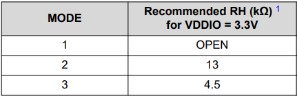

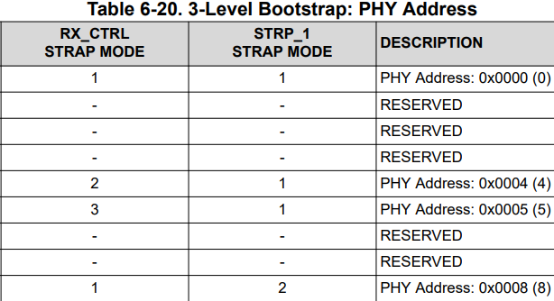

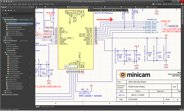

I cannot interpret the datasheet (sorry!). The present design configures the PHY to address 08 by fitting a 13K pullup resistor to STRAP_1 pin. However I want to move it to an address in the range 1 to 7 e.g. 5. Do I need to use a different resistor value if so please specify it or do I need an additional pullup on pin RX_CTRL? On the eval board both pins have 13K pullups resulting in an address of 01100 which is out of range.
