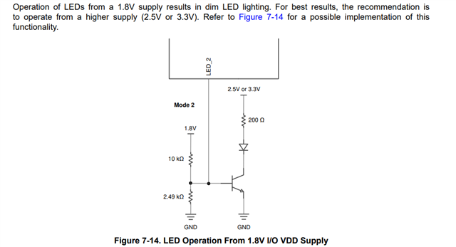

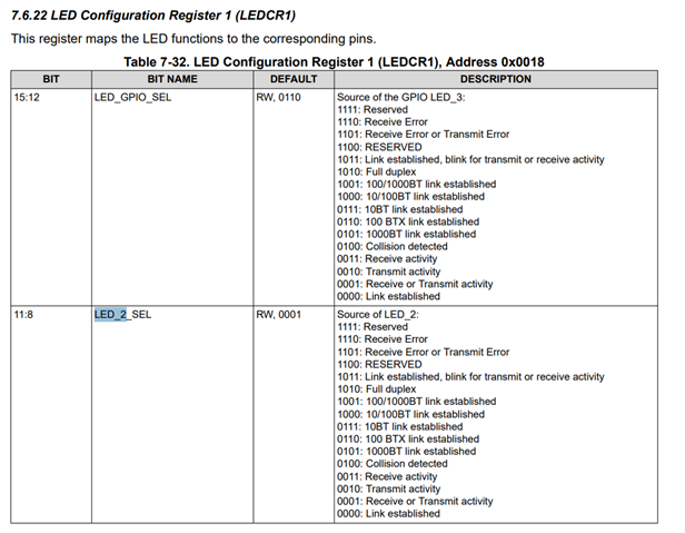

    LED2 pin auto-detects the polarity at the power up. LED_2 pin also is set to show TX/RX activity so if there is link and packet transmission the LED will be ON.
    To indicate link status, you will have to change the register setting below:
    Below is the strapping recommendation from our datasheet:
    Please let me know.
    J

    I understand that LED_2 is configured by default to show TX/RX activity. However, our specific requirement is as follows:
    We want LED_2 to reflect the actual link status — i.e., the signal should change state when the Ethernet cable is connected or removed. This is necessary so that our FPGA logic can detect cable presence and display "waiting for Ethernet ready" accordingly.
    Could you please confirm:
    1. Is this behavior achievable by changing only hardware strapping (e.g., resistors)?
    2. Or is a register configuration (via MDIO or boot mode override) also needed?
    3. If register change is required, which specific register and value should be used to set LED_2 to reflect link status only?
    Any recommendations or reference configurations would be very helpful.
    Thanks again for your support.
    Pavithran Gunasekaran
    1. The described behavior will not be achievable via hardware strapping.
    2. Register modification via MDIO is required. Please refer to the register screenshot above.
    3. Please refer to the screenshot above.
