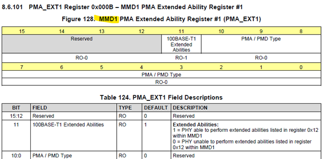

  • hello David, do we have a detail datasheet to introduce the MMD mapping for the Clause 45 registers,
    for example, I read manual "SNR Register 0x0197 " register, but I dont know what is the MMD field, is it in 0x1 or 0x1F, in your docuemnt, it dont mention.
    please give a advise.
  • Hi Yetao,
    Registers 0x0 - 0x1F are available through direct access.
    Registers in MMD1F are shown in section 8.6.21 - 8.6.102.
    Registers in MMD1 are shown in section 8.6.103 - 8.6.107.
    David
  • hello David,
    I am a bit confused , which datasheet version you refer to,
    I read the docuement, it show Section 8.6.101 register in MMD1
    the document is
  • Hi Yetao,
    Apologies. I was referring to DP83TC811S-Q1 datasheet.
    In DP83TC811R-Q1 datasheet, the below is true:
    Registers in MMD1F are shown in section 8.6.21 - 8.6.99.
    Registers in MMD1 are shown in section 8.6.100 - 8.6.104.
    David
