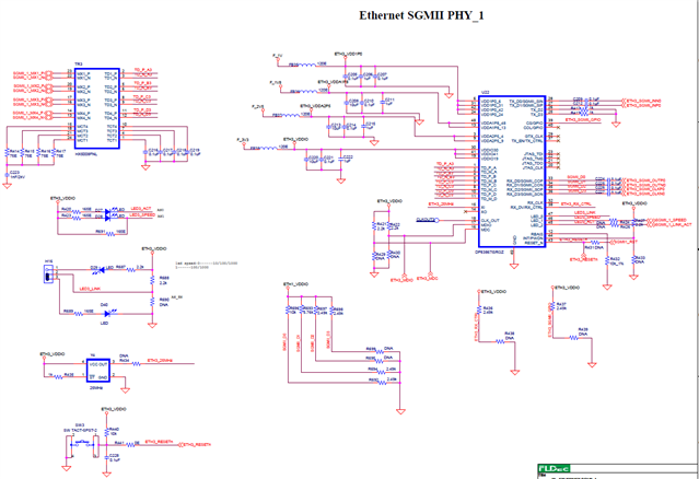

  • We have powered the PHY and verified that all the power rails are delivering the expected voltage levels.
    For your reference, I am attaching the schematic. Kindly review it and let us know if any further action is needed.

    Below are the comments on the schematic:
    1. MDC does not need pull up to VDDIO
    2.

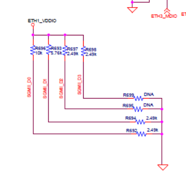

    Please ensure that SGMII_D0 and SGMII_D1 strap resistors match so that the loads on SGMII lines are balanced.
    3.

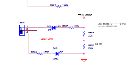

    Looks like LED_0 is strapped to mode 4. This will put the PHY in mirror mode which requires MDI connection to be flipped. Your MDI connection is not flipped so that will cause an issue. Could you put this strap pin in mode 2 (10k pull up and 2.49k pull down) to disable mirror mode?
    4.

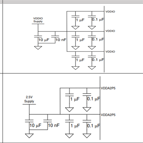

    We recommend 1uF and 0.1uF per power pin:
    5. Is auto-negotiation disabled on purpose?
    This has to be in mode 3 to enable auto-negotiation.
    Please let me know.
