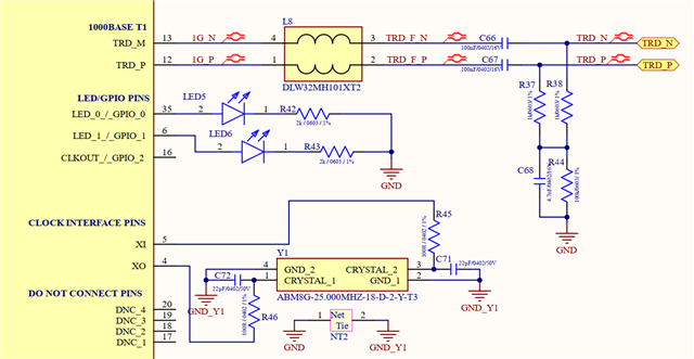

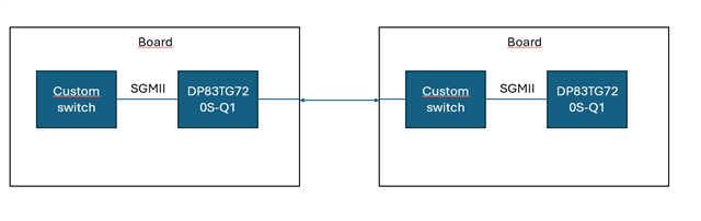

I'm working with the following schematic:
The two boards are identical, and I believe the SGMII configuration is correct. I'm using the official RTOS driver; however, a link is never established between the two physical devices.
Since the driver does not provide an initialization function, I created one myself, though I'm not sure if it's implemented correctly.
According to the logs, the PHY in use is a DP83TG720_CS1_1. Naturally, I have configured one side as master and the other as slave.
I'm attaching my code below for additional context.

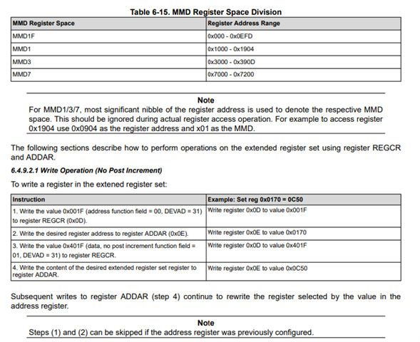

static int32_t Dp83tg720_readMmd(EthPhyDrv_Handle hPhy, uint16_t devad, uint32_t reg, uint16_t *val)
    int32_t status;
    Phy_RegAccessCb_t* pRegAccessApi = PhyPriv_getRegAccessApi(hPhy);
    status = pRegAccessApi->EnetPhy_writeReg(pRegAccessApi->pArgs, PHY_MMD_CR, devad | MMD_CR_ADDR);
    if (status == PHY_SOK)
        status = pRegAccessApi->EnetPhy_writeReg(pRegAccessApi->pArgs, PHY_MMD_DR, reg);
        pRegAccessApi->EnetPhy_writeReg(pRegAccessApi->pArgs, PHY_MMD_CR, devad | MMD_CR_DATA_NOPOSTINC);
        status = pRegAccessApi->EnetPhy_readReg(pRegAccessApi->pArgs, PHY_MMD_DR, val);
    //PHYTRACE_VERBOSE_IF(status == PHY_SOK, "PHY %u: read reg %u val 0x%04x\n", 0x0F, reg, *val);
    //PHYTRACE_ERR_IF(status != PHY_SOK,"PHY %u: failed to read reg %u\n", 0x0F, reg);
	return 0;
static void Dp83tg720_writeMmd(EthPhyDrv_Handle hPhy, uint16_t devad, uint32_t reg, uint16_t val)
    int32_t status;
    //PHYTRACE_VERBOSE("PHY %u: write %u val 0x%04x\n", 0x0F, reg, val);
        pRegAccessApi->EnetPhy_writeReg(pRegAccessApi->pArgs, PHY_MMD_DR, val);
    //PHYTRACE_ERR_IF(status != PHY_SOK,"PHY %u: failed to write reg %u val 0x%04x\n", 0x0F, reg, val);
static void Dp83tg720_setBitsMmd(EthPhyDrv_Handle hPhy, uint16_t devad, uint32_t reg, uint16_t val)
	uint16_t value;
	int32_t status;
	status = Dp83tg720_readMmd(hPhy, devad, reg, &value);
		value = value | val;
		Dp83tg720_writeMmd(hPhy, devad, reg, value);

Could you help me identify what might be missing or incorrect in the setup that prevents the link from being established?
Daniel

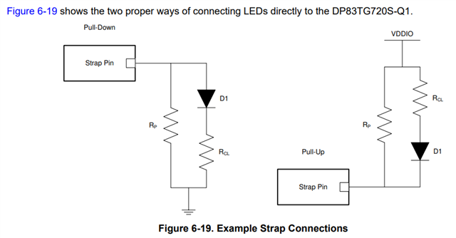

  • Hi Daniel,
    Have you checked the bootstrap pin configuration?  Do you have schematics you can share?
    Please see the below link for a document to help with a few initial debug steps:

    Regarding the bootstrap pin configuration, they are correct. At the moment, I cannot share the schematic. The only pin I have doubts about is INH, which I have left open. If I read register 0x16, the device reports it is in normal power mode.
    I would also like to confirm whether my initialization function is correct, as it is not provided by default in the driver.
    As additional information, the chip in use is DP83TG720_CS1_1.
        int32_t status;
    	return 0;
        int32_t status;

    Just to clarify, register 0x1834 is in extended register space and requires indirect access to write.  Just want to make sure this was done.  Writing to that register should configure Master mode.
    Could you confirm the bootstrap pin resistor values?  Are power rails coming up at the same time?
  • Can you also measure the voltage on the LED0 pin?
    First of all, thank you for your help, yes, I am using indirect reading and writing (clause 45).

    Can you confirm the bootstrap pull-up resistor on LED0 is the recommended 2.1K-2.5K Ohm?  After the value is latched if LED0 is not configured it will default to an output with ~9K Ohm internal pull-down.
    Undrea
  • Hi Andrea,
    I have a 2k ohm resistor. I have added an image:
    Daniel

    After power-up or RESET, LED0 is initially sampled as an input to configure the mode (Master = VDDIO, Slave = GND).
    For Master mode, LED0 should have a pull-up to VDDIO.  Below is an example from the datasheet to configure as either Master(PU) or Slave(PD).
    Undrea
