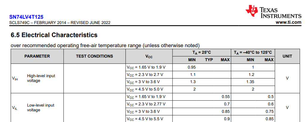

Hello Team,
Can you please help clarify the datasheet has inconsistencies in the 2.5V and 5.0V VCC operating ranges for VIH/VIL. VIH/VIL testing utilizes 2.3V and 2.7V for the 2.5V range and 4.5V and 5.5V for the 5.0V range.
