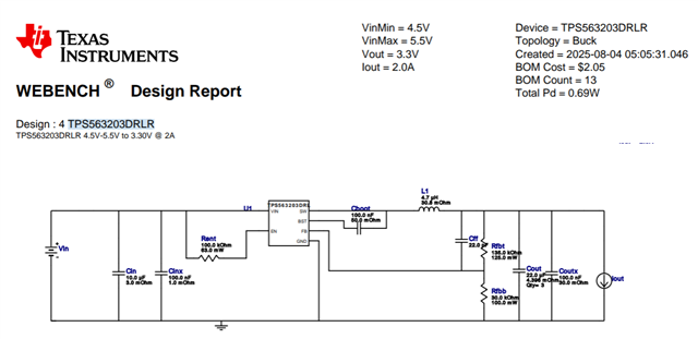

We want to go with simulated circuitry in WEBENCH.
Query:
1. Suggested inductor (74437349047) value is 4.7uH/6.2A. Can we go with inductor with lesser current rating 3A, since my output current is not going to exceed 2A ?
2. How much time Cout of 66uF can sustain, in case of input dip? Is there any calculation?
3. We are generating 3 outputs (3.3V, 2.5V & 1.2V) from same source of 5V, (output of DC-DC converter, filter is given at input of this DC-DC converter), so EMI filter is not required at input of this buck converters, we believe. Please share your thoughts on this.
  • Hi Mitesh,
    1. Please use inductor whose current rating should be more than 3A, because ripple current is minimum of 20% of load current it means in your case it would be 600mA.
     then IL = 2.6A.
    2. For this, you have to do simulation, or you have to test the board.
    3. You can ignore the EMI filter.
    Manish
