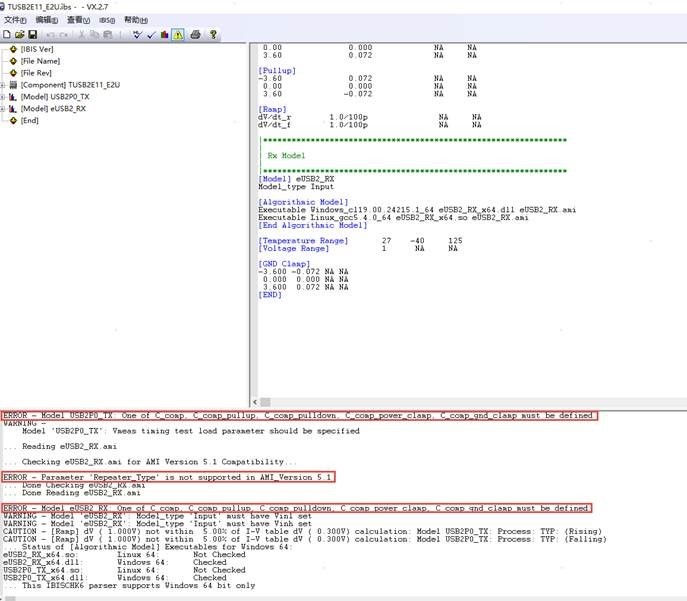

Hi Team,
My customer is now evaluating TUSB2E11EVM and they find the following error, could you please check whether there are some wrong setting? Thanks.
BRs.
Frank

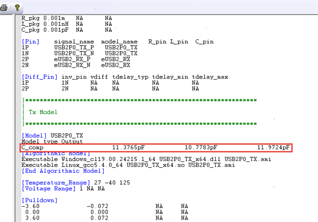

  • Hi Team,
    Adding one more question:
    customer find adding the value in the red point then it works, can you help to explain how to set this value appropriately? Thanks.
    BRs.
    Frank
  • Hi Frank,
    What software is your customer using? We typically use ADS for our IBIS models, where we don't see this error with these C_comp values.
    For the 'Repeater Type' parameter, it looks like this is just checking for compatibility and may not necessarily gating performance of the model.
    Can the customer still run the model even with the compatibility error? How does the model look with the current values for C_comp?
    Ryan
  • 我们用的是ANSYS的circuit design
  • Hi Yifeng,
    Can you send a link to the software we use? That way we can try to reproduce on our side.
    Can you also double check these questions?
    Additionally, if possible, replies in English would help me understand your responses better.
    Ryan

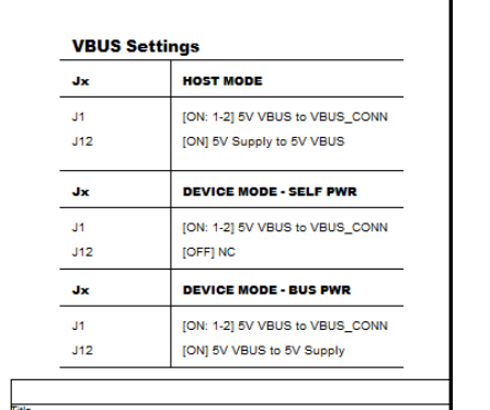

  • hi ,I tested on your demo EVB, but found that the chip is not working. If I want to configure it to a mode that does not require BC1.2 and IIC (the chip works automatically when powered on), the current setting is SCL grounded through 90R and SDA grounded directly. Is the configuration correct? Are there any other things to pay attention to?
  • Hi Yifeng,
    What do you mean by the chip not working? Like, you cannot get any signal through the TUSB2E11EVM, or any USB connection?
    For the TUSB2E11EVM, there should be header pins for controlling the SDA/SCL pins to correctly configure the EVM. You should be able to use these jumper settings if you don't plan on using I2C or BC1.2:
    What settings are being used for the other GPIO? What do you have the EVM connected? An eUSB2 SOC to a flash drive, or a different connection type? What about the VBUS jumpers?
    Ryan
  • 1、I connected it according to the design instructions, with SDA/SCL connected to GND
    Q:Does this correspond to the non IIC mode and not requiring BC1.2
    2、 ,I don't use J1 and provide external 5V power supply  though J12
  • I test 3.3/1.8/5v on EVB and they are OK
  • Hi Yifeng,
    Yes, with both to ground, it would be set to I2C mode with BC1.2 disabled.
    Does the EVM work when you supply those voltages? Or is the board still not working?
    Do you have the EVM connected to an eUSB2 SOC that's acting as a device or a host?
    Looking at the schematic, you may need to supply 5V to both pins of the jumper. Have you already tried this?
