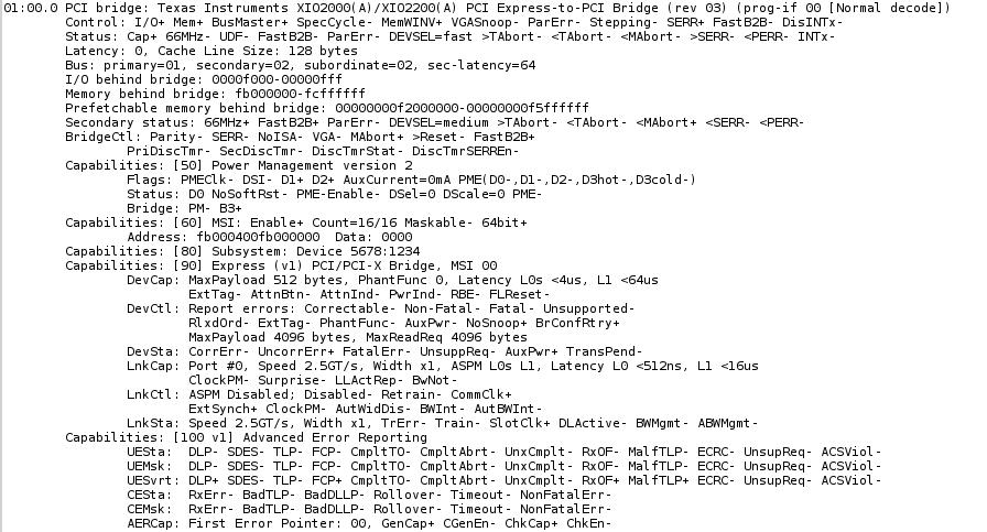

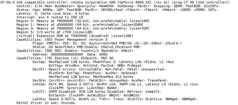

I need to access Memory-Mapped TI Proprietary Register Space of XIO2000A. How do I find the base address where those registers are mapped to?
lspci -vvv gives me:
PCI Device behind the bridge:
cat /proc/iomem gives me:
My OS is Linux with kernel version 2.6.34-12.
Thank you for your reply.

  • The Base Address Register for the registers in section 3.5.2 and 3.5.3 are mapped through the Device Control Memory Register at PCI offset 10h. Refer to table 6-1 for the memory map for all the Device Control Memory registers.
