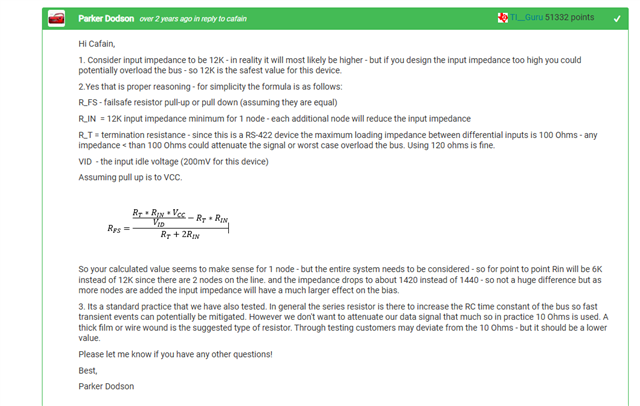

I have some questions regarding the design of the AM26C32.
  1. I am considering an external fail-safe circuit. I plan to connect Vcc to the positive side and GND with a resistor to the negative side. I intend to calculate the resistor value using the internal pull-up/pull-down resistor of 288kΩ and the input impedance of 12kΩ. What is the tolerance range for the 288kΩ resistor?
  2. Is a power-limiting resistor necessary when implementing the fail-safe circuit? If so, what should the resistor value be?
"I would greatly appreciate your response.
  • From the response of Parker Dodson.
    "Additionally, it is stated that the resistance value of the pull-up resistor can be determined using the following formula. What is the original formula, and what kind of transformations were applied to it?"
  • I am considering an external fail-safe circuit. I plan to connect Vcc to the positive side and GND with a resistor to the negative side. I intend to calculate the resistor value using the internal pull-up/pull-down resistor of 288kΩ and the input impedance of 12kΩ. What is the tolerance range for the 288kΩ resistor?
    I think the tolerance for this can be as large as 25% for the internal pull up and pull downs but normally the external fail safe resistors are so small that it you can basically ignore them.
    Customers normally put a small 10 ohm resistor infront of the inputs when they expect there could be a large transient event that could damage the device. It's not required but it depends on the application or expectation on if a large transient could appear. 10 ohms is normally what I see.
    https://www.ti.com/lit/an/slyt324/slyt324.pdf?ts=1754602842600&ref_url=https%253A%252F%252Fwww.google.com%252F
    This document walks through how to calculate external pull up and pull down resistances.
    I think the equation Parker derived was something he did himself.
