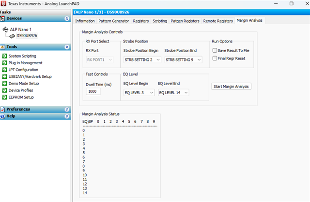

    Another option for verifying link integrity at different EQ levels (there is an adaptive equalizer on the 926 for this scenario), is to use the ALP application with Margin Analysis to determine if there is sufficient margin at different lengths. Please see the example of the environment below:
    References:
    As long as FPD-Link components over the link are meeting signal integrity, and 92x/94x channel specifications, lock should be stable under these conditions.
