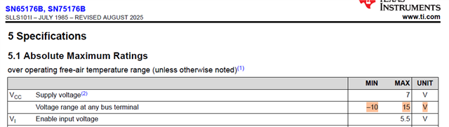

  1. I understand that the AMR for both A and B pin,with respect to Pin5. are -10 to 15V, is it right?
  2. Are there  differential AMR value for A-B and common AMR value for (A+B)/2?
  • 1. Yes.
    2. No; all combinations of voltages at the A/B pins are allowed.

    1. Can I understand that MAR value for the differential voltage of A-B is +-25V, and MAR value for A-B common voltage is -10v to 15V?

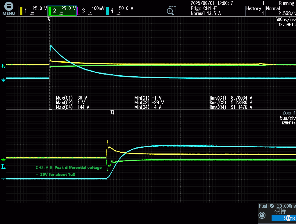

    2. To compete with TPT75176HL1, customer needs to know what is the differential peak voltage of A-B with pulse transient condition. such as +-100V listed in TPT75176HL1;
    3. The -29V for about 1us A-B of SN65176B is measured on customer board during lightening test, the waveform is as following in which CH2 (Green) is A-B voltage. is there risk for sn65176B?
  • Ken,
    our device's warranty is based on the abs max rating. -29V is larger than the abs max differential (-10V-15V=-25V). So we cannot guarantee the device will survive this. We would need to recommend the customer place a bidirectional TVS diode between the A-B pins to clamp the voltage since 1uS is actually kind of long.
    Based on what you're showing you may want to try to move the customer to our THVD24xx family which has higher abs max ratings to handle these rougher environments.
    -Bobby

  • Ken,
    The other alternative I can think of is to place a bi directional TVS diode between the pins to clamp the voltage. We can ask the protection devices product line for a recommendation if they can make that change (may required a PCB spin).
