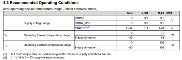

I am using the TUSB7320 part. I see conflicting specs for the Vcore. Is it 1.05V or 1.1V?
Hi Jon,
For VCore, you are also referring to the 1.1V rail, correct?
This rail is recommended to be between 1.045V and 1.21V. VCore can operate at 1.05V as long as the minimum supply conditions are met, though we do typically recommend 1.1V for this rail.
