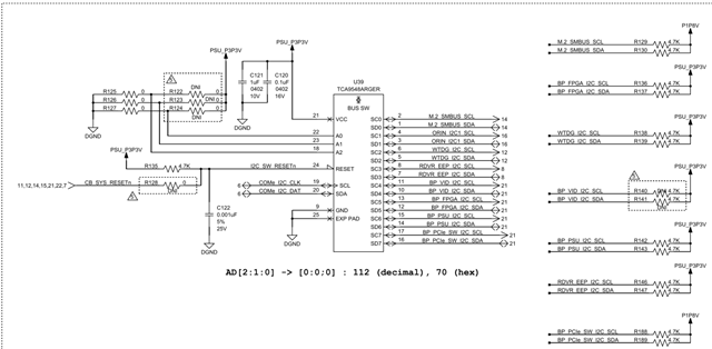

  I am using 8-Channel I2C Switch (TCA9548A), where I am connecting all the 8 channels to 8-slave devices individually.
We are facing issue with the I2C switch operation, as it is not working when one of our slave device (CH-1, Jetson AGX ORIN processor) made OFF in the run time.
As Jetson AGX ORIN (CH-1) we have not provided external pull up for this CH-1.

Attached here the schematic of the I2C switch IC.

  • I suspect that the Orin, when powered off, pulls both I²C signal lines low. This prevents any I²C communication, including communication with the TCA9548A itself.
    You need proper error handling. When the TCA9548A does not react, reset it.

        1. When we probe the I2C lines after powering OFF the Orin, we see 'high' on both SCL/SDA lines.
        2. We did reset the TCA9548A device when the ORIN is OFF, but as previously said, still it failed to detect the devices on all the channels.
  • Does the I²C communictation to the TCA9548A itself still work? Please show an oscilloscope trace of SDA and SCL.
  • Hi  ,
         We do not have the probing point between the SOM module and TCA9548A.
    We have checked through the software that TCA9548A indeed down and not responding when the ORIN is OFF.

    If you never select the ORIN, but turn the ORIN off, does the device work properly? For example, if the ORIN is off and you try to write on channel 6 then channel 7?
    I suspect that when turned off, the ORIN just pulls Channel 1 high, overwriting COMe which is trying write to Channel 1.

    When ORIN is OFF, if we select the ORIN channel first from SW and then any other channel, MUX is failed to detect the respective channels.
  • Hi Ammasi,
    We really cannot diagnose anything else without scopeshots. It seems that the Orin is the issue and might be driving the reset pin or overriding whatever data is trying to be sent on SDA but holding it high.
    It would be good to verify if you can communicate directly from COMe to the Orin without the TCA, but again we won't be able to help debug anything else without scope shots.
