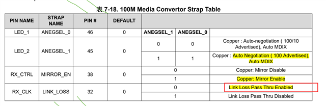

I was going through the data sheet and additional documents believing it will work until I read SNLA318 where it's stated without any other related reference in any other documents that there is a
"Required register configuration for 1000 Mbps Media Converter mode: - Write 0x1FFC to register 0x01EC (set bit [0] to 0"
which would render a straps-only implementation unsuccessful. So my question is very simple, is a straps-only configuration in 1000 Mbps Media Converter mode with the DP83869 possible or not?
The data sheet seems to imply that it is...
PHY Strap Table Configuration
RX_D0 = PHY_ADD[1:0] = 0 (def)
RX_D1 = PHY_ADD[3:2] = 0 (def)
OPMODE[2:0] = 4 (1000Base-T to 1000Base-X) »
   JTAG_TDO/GPIO_1 = OPMODE[0] = 0 (def)
   RX_D3 = OPMODE[1] = 0 (def)
   RX_D2 = OPMODE[2] = 1
LED_0 = ANEG_DIS = 1 (Fiber Force Mode)
ANEGSEL_[1:0] = 3 (Copper : Auto Negotiation (1000 Advertised, Auto MDIX)
LED_2 = ANEGSEL_1 = 1
LED_1 = ANEGSEL_0 = 1
