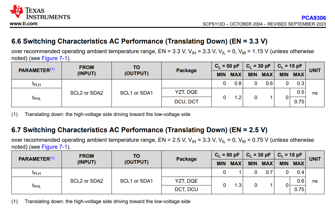

Customer is working to design a 1.8V <--> 3.3V I2C level shifter circuit.
They used to use PCA9306, while when I review their circuit, I suggest them goes to TCA9416 based on the our comment understanding than TCA devices are better and more recommend as following link described.
https://e2e.ti.com/support/switches-multiplexers-group/switches-multiplexers/f/switches-multiplexers-forum/1304261/faq-what-are-the-differences-between-pca-and-tca-i2c-switches?tisearch=e2e-sitesearch&keymatch=PCA%2520vs%2520TCA#

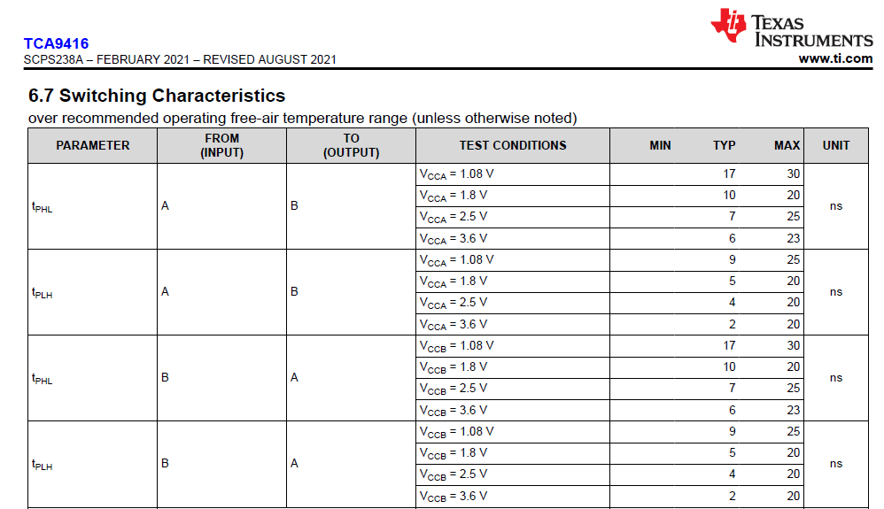

While customer feedback they find the TCA9416 has much larger delay spec as following shows, than PCA9306.
TCA9416:
PCA9306:
Could you help check what cause the TCA9416 get much higher delay? Any more recommendation part for PCA9306?

    TCA9416 introduces the rise time accelerators in addition to the shared passFET architecture of both devices mentioned here. As a result, the propagation delay is increased marginally. However I do not see this as a concern as I2C signals are not that fast in nature, so the difference is OK.
    The PCA9306 having a small tpd is because the device is simply a FET that opens and closes to form connection between input/output, hence there is very little delay period between the two ports.
    Is there a particular problem that they are attempting to address?
