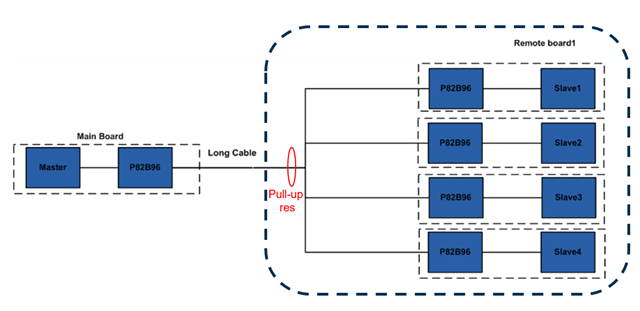

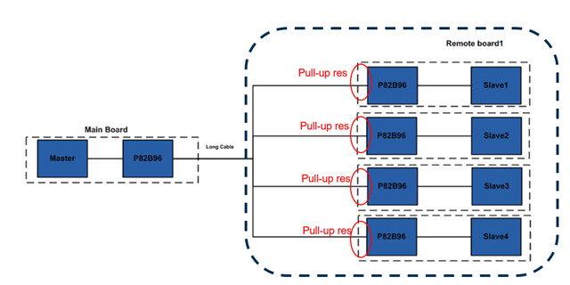

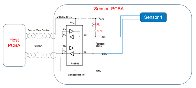

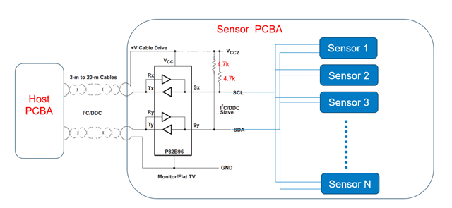

We have a project is using P82B96 as following picture, previously only one sensor and the system working fine, now we need to increase sensor from 1 to 8 on the same PCBA, can we use the same P82B96?
VCC is 5V, the total PCB trace of I2C bus on the sensor board is around 10,000 - 15,000 mil. PCB trace capacitance: ~25pF, slave chip MCP3427-E/UN pin capacitance 10pF *8 = 80pF.
Please help review and advice will it work, thanks.
