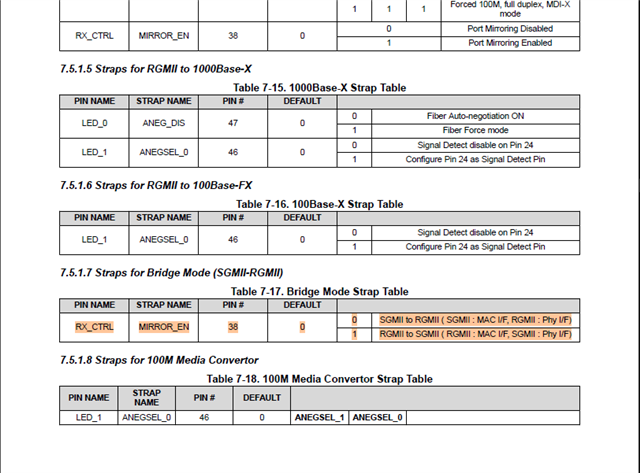

Hello, in this if we want to have MAC to MAC connection, what will be the strap setting of this pin?
