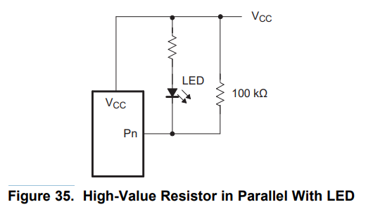

TCA9555: External I/O Pull-up resistor
Part Number: TCA9555
Other Parts Discussed in Thread: TCA9535
For battery-powered applications.
The TCA9555 includes pull-up resistors for I/O, so the TCA9555 does not require additional external pull-up resistors for I/O.
The reference circuit in Figure 35 is only applicable to the TCA9535.
Is that correct?
