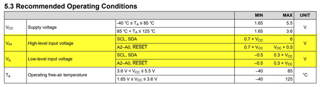

  • Hi Syed,
    The VIH/VIL levels are in the datasheet:
    1.26V for VIH and 0.54V for VIL @1.8V.

  • Hi Syed,
    There is no VIH/VIL for those channels. Once the channel is turned on on the SDA/SCL side it acts as a passive FET so the signals will just communicate through. At that point, the VIH/VIL of your I2C controller and peripherals will be the specs that you care about for sending and receiving data. If you want to change the configuration of the TCA device then you'll one again care about the VIH/VIL levels of just the SDA/SCL again.

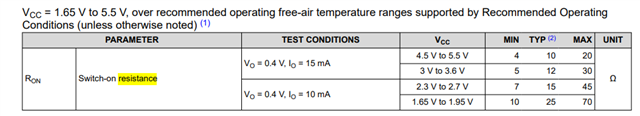

    As mentioned, the TCA9548A will not have VIH/VIL on those 8 SDx/SCx pins. You can think of Vpass as the VIH in some ways. But the truth is that once you select the path, the TCA9548A will act as a pass FET.  Efectively it will be a resistor with the on resistance showns below:
    For your setup you will use 1.8V on VCC and hten pull up the main bus to 1.8V.
    You will then pull SD0/SC0 to 1.8V, SD1/SC1 to 3.3V and so forth for all yoru bus voltages.
    If the VIH/VIL/VOL values do not match then please share an schematic, highlight where your concern is and the actual values. But from the mux perspective, as long as the VIH/VIL matches the VOH/VOL of the AGX Orin SOM you mentioned that is driving the main bus, you will fine.
