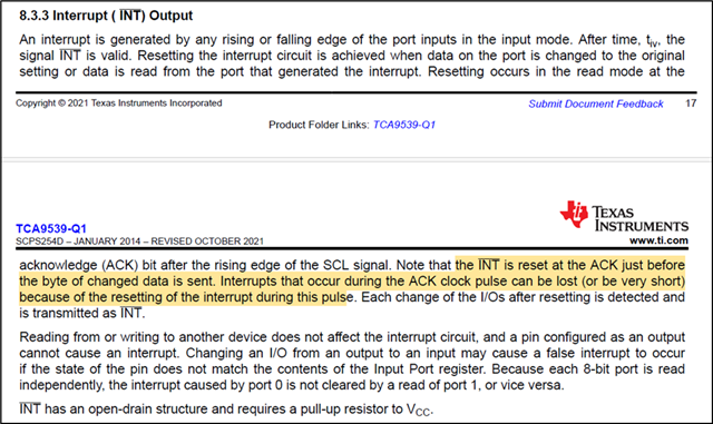

About “Interrupts that occur during the ACK clock pulse can be lost (or be very short) because of the resetting of the interrupt during this pulse.”  I have 2 questions:
  1. Do you have a more intuitive diagram to illustrate this?
  2. What I understand is that the lost interrupt is caused by rising or falling edge of the port input occurs at the ACK bit, then it causes the time of /INT=0 is short. Is it right? If my understand is right, any methods to avoid this interrupt lost?

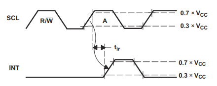

    I do not have an exact diagram to show this behavior.
    I can show the timing diagram in the datasheet:
    where Tir is the time where an interrupt can be lost or very short. Tir(max) <= 4 us which means an interrupt during this time is either very short or is lost.
    If interrupts being lost is going to be a problem for the customer, we need to consider a device that has a buffer for data changes that occur during the interrupt assertion. A device such as TCA8418E is a keypad scanner with a 10 byte fifo that keeps track of input changes (up to 10 changes) even during the ACK bit.
    The interrupt is "lost" because there is only 1 interrupt pin for both ports. For example, if P00 changes state and causes /INT = LOW, and the interrupt is processed by the MCU, it sends a read command through the I2C bus. During the ACK bit pulse, SCL samples the ACK bit, during a time Tir -- P01 changes state, but the /INT = LOW already so the interrupt is "lost" because all I/O's are connected to a single interrupt.
    So, the "lost" only means lost the interrupt to MCU, the real value of P01 is already uprated in the register?
    Leo
  • Hi Leo,
    This is correct. The P01 pin would have triggered the /INT LOW the same as P00. Given that it occurred during the ACK related pulse with /INT already LOW, the MCU only sees 1 interrupt from the original state change on P00, not P01. The MCU can still read the input port register to see that both P00 and P01 have changed state.
