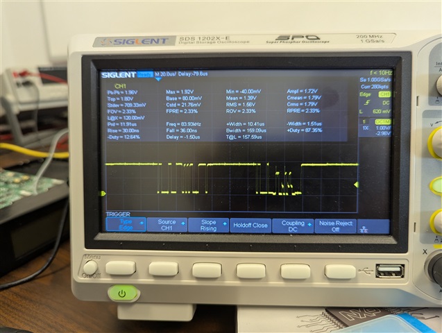

  • Well we found interesting evidence related to this issue.  We monitor the MDIO_MDC signal while the PHY is sending/receiving data.  The signals are usually good but if there is a concurrent PHY transfer, the MDC signal goes to full, half and quarter voltage levels.  Its as if the VDDIO pull-up voltage sags or maybe there is a clamp limiting the maximum voltage during those times.  Not sure if its the PHY or the AM6254 processor however.  And it appears to be independent of MDIO hardware vs bit-banging.
  • Interesting find. Are you certain this is the MDC signal? It looks more characteristic of the MDIO line. MDC would look like a clock signal when data is transmitted.
    I haven't seen that behavior on our PHY EVMs. From the PHY perspective, MDIO should be open drain (no pullup to VDDIO in the PHY) so the PHY shouldn't be sagging this. Typically you would have an external pullup on the MDIO line.

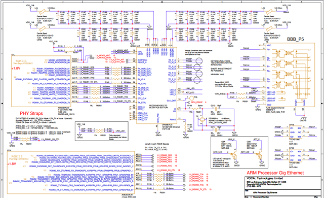

    Thank you for the update. Can you share a schematic of the MDC/MDIO lines? I'd like to see the full path from your controller to both PHYs if possible.
    Are the PHYs using different MDIO addresses?
    Shane

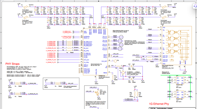

  • The full path runs over three boards.  The main board Ethernet schematic is below.
    The second PHY schematic is below:
    I should note that we caught and corrected the pin-out error for LED_0 and LED_2.  The nets were swapped on the second PHY in order to configure that board to use Mirror mode.
    Yes the PHY's are at two different addresses.
    Just to recap, we read incorrect status from the working PHY (incorrect down) and the disconnected PHY (incorrect up) when both PHY's are non-reset and there is a packet transfer occurring during the MDIO operation.  That is when the incorrect voltage levels were seen.  If we hold the disconnected PHY in RESET, we get proper link status reads.

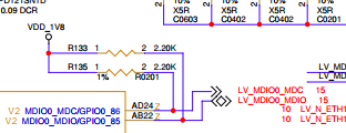

  • Hi Victor,
    I see what looks like two sets of 2.2K pullups on both MDC and MDIO. One near the processor and one near the U3 PHY. MDIO should have one 2.2K pullup and MDC does not need one (from the PHY perspective). Does removing one of the MDIO pullup resistors fix the incorrect voltage levels?
    Additionally I do not see where the PHY-side center taps are terminated in your Magjack. DP83867 should have 0.1uF capacitors to GND on each center tap, and the center taps should not be shorted together:

  • What you did not see is an I2C bus isolator used on the board with the Ethernet PHY.  From what I understand we need the pull-up on both sides of the I2C level shifter/isolator.

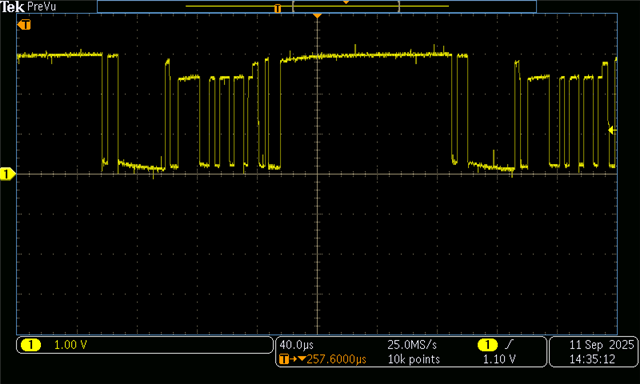

  • This is something I can not answer without a fair amount of programming effort.  What we do see from the captured trace is a series of bits that are probably in error.  I suspect the bits near the low level are being driven different ways by each PHY.  I know MDIO is supposed to be open drain but this waveform can not be explained as open drain.  Its being driven push-pull.
    Keep in mind this only happens when the second PHY is not in use (but not held in RESET) and there is RGMII activity to the first PHY.
