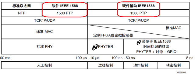

In addition, the app note mentioned the software approach. Using a standard MAC and PHY can also achieve PTP.

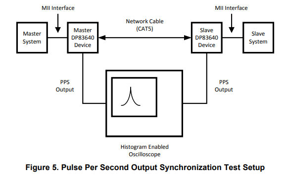

  • Hi Shane, Can PPS alone achieve synchronization accuracy better than 1 ms in your setup, or would hardware timestamping be required to reach that level?
  • Hi Mr. Jack,
    From the linked app note section 5.3, the average PPS synchronization between the two connected PHYs is ~869ps with a standard deviation of 7.87ns. From this, the PPS signals of the PHYs can be synchronized within 1ms.
    Are you asking whether the PPS from the PHYs can synchronize the other clocks in your system to within 1ms? On further inspection the PPS alone likely will not synchronize the clocks as it is mainly a reference signal.
    You can use the 1588 output clock from the PHY as a reference PTP clock, but if you want true PTP synchronization you should send the timestamp data from the PHY to a PTP software stack.

  • Hi Shane,
    1.Our objective is to synchronize the system time of a Master and a Slave, with a synchronization error of less than 1 millisecond (ms). We are considering two methods: pure software implementation of IEEE 1588 and hardware-assisted IEEE 1588. Can both of these methods achieve our required accuracy?
    2.Do both the master system and the slave system need to support PTP, or is it sufficient for only the two DP83640 devices to support PTP?
  • Hi Mr. Jack,
    1. Yes for <1ms accuracy a pure software approach will likely work. Hardware-assisted timestamping can improve the accuracy down to the nanosecond range, but may not be necessary here.
    2. Both Master and Slave systems need to support the IEEE1588 PTP software stack. A standard MAC/SoC should support this stack as it is software based, but check with the SoC manufacturer to be sure. The PTP hardware support from DP83640 is primarily to improve the accuracy of the PTP synchronization.
