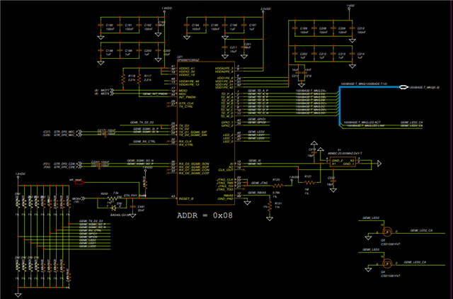

My team designed a board with three Ethernet connections, which means it includes three PHY components DP83867, all connected to the same MDIO lines but with different addresses (4, 8, 12).
In addition, the board has a processor running a linux operating system that communicates with the components on the board.
When the board is powered on, all three Ethernet ports communicate successfully, but after several hours of operation, one of the ports stops communicating and the operating system outputs the message:
[ 1047.865770] TI DP83867 ff0b0000.ethernet-ffffffff:04: Master/Slave resolution failed
After this happens, it is no longer possible to access the PHY via the MDIO lines.
Could you help us figure out how to prevent this issue?

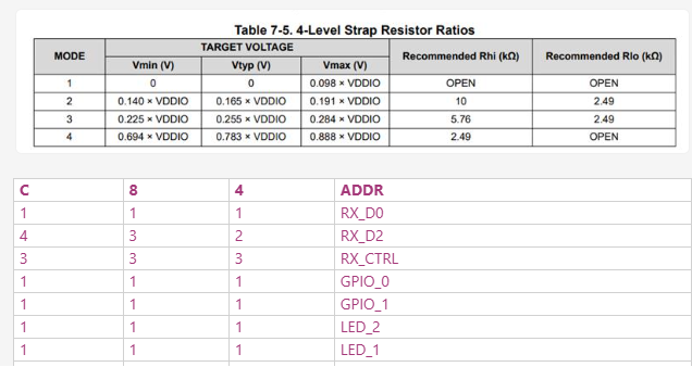

    Could you give us more detail about the PHY's strap configuration?

    Which PHY is dying? Also, is the problematic PHY detectable on Linux after the error statement?
    It seems like all the PHYs are in the same strap setting with only difference being the PHY address.
    Is there any additional log on the Linux side? Could you also share the schematic so we can better take a look at this problem?
    Currently, it seems like it could be power dip on one of the voltage rails causing the PHY to get stuck in a bad state.
    When the PHY gets into the bad state, could you probe RBIAS pin and see if it is outputting 1V and could you check if there is clock going into XI pin when the PHY is in the bad state?

    schematic -
    all power rails are common to all phys so if there is problem in power source it will affect all the phys.
    I checked when the phy dying RBIAS= 1V, and there is clk in XI pin.

    link for schematic-
    There are 3 pictures of each ethernet connection with a different address
    https://imgur.com/a/XHzolxd
