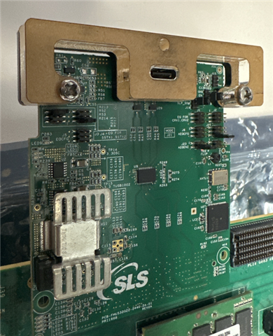

I have programmed the Altera board with the .jic file
Specifically with:
 https://e2e.ti.com/cfs-file/__key/communityserver-discussions-components-files/138/usb32dc_5F00_a10socdb_5F00_fmcusb32g22_5F00_con1_5F00_lane1_5F00_i2c.jic
I still cannot get enumeration to happen on our host PC.

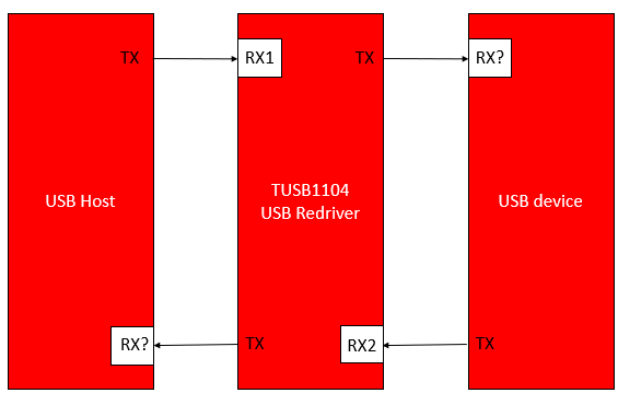

  • Understood. This is proving difficult to isolate the issue. I do not see any major differences that would explain the gap in performance between lane1 and lane2 on the daughtercard, FPGA, or the host side. My next question would be the EQ capability of the FPGA device. Does lane1 and lane 2 have the same EQ capability?
    As we know in a linear redriver system EQ can only be provided on the redriver. Due to this limitation we must rely on the host and device EQ to compensate for what the redriver cannot. We can see this in the below diagram.
    We know that the TUSB1104 can operate within a compliant USB system as we have passed compliance testing with this part. We need to delve deeper into the system itself to debug why one lane is working and the other isn't.
  • Hi Quick update.
    I tried testing you system with a standard USB RX Jtol test for a USB device, but the FPGA does not go into loopback mode. This test would provide insight into what the USB3.2 waveforms coming out of the FPGA system look like. However, this test does work well with your system as we need to send the command over the USB Type-C connection to start loopback mode.
    I have both lane1 and lane 2 as stable as possible for the GPIO modes. Iwas able to do this by making the daughtercard and FPGA connect more solidly by providing more support to the daughtercard.
    Lane 1 has no errors for test >30mins long.
    Lane 2 has no errors for test >10 mins long, but occasionally has 1 or 2 recoverable errors in longer tests.
    This should mean that when using USB3.2 gen 2x2 we should see a few errors but the link should still operate. However, when using in 20Gbps mode the link fails almost immediately.
    The links individually working, but not working when used together imply a possibility of crosstalk being the culprit. We have had issues in the past where socket connector have poor crosstalk performance. I am looking further into this option.
    Do you have any s4p files for the connect used here? Additionally are you able to reduce the amplitude of the USB signal from the SoC to see if this affect the SI at all?

  • 1)Have you changed default Pin-Strap Mode setting which we have fixed while supplying cards?
    I dont recall what the default pin-strap configuration is. This is the current config.
    2) Yes, I have a PC which is able to program via I2C, but I am unable to get the I2C board to enumerate.
    3) I have tried this testing, but the FPGA is unable to get into loopback mode here. I am debugging this currently.
    4)Have you got below improved performance by changing any Pin-Strap Mode setting Or I2C Based redriver setting of AEQ Or by pressing Daughter Card to make solid connection with FPGA Motherboard.
    The pin-strap configuration is shown above, I notice that slight changes in the angle of the Daughtercard connector leads to performance differences in the USB validator GUI I am testing with.

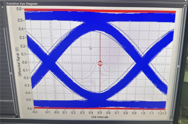

    Sorry for the delays. It took some time getting the setup working. However, I am able to test the TX eye diagrams now!
    Thanks for the help. I have noticed that we fail the short channel template test as the eye diagram exceeding the maximum output swing.
    Were we aware of this?
    We do pass long channel eye diagram testing on lane 1 with no issue. I will test lane2 and 2x2 tomorrow.

    As of right now the TX eye diagram looks the same for con1_lane1, con1_lane2, and gen 2x2. Wes till see the same issue of too wide of an eye diagram for the short channel across all 3 tests, but the rest of the test pass across the board.
