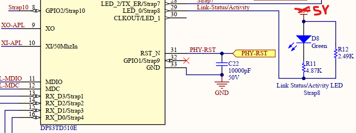

I have an application where I would like to use 5V to pull up the DP83TD510E LED_0 pin to drive an LED. Is that pin 5V tolerant? Would the following circuit work?
Part Number: DP83TD510E
Hi Cyrus,
The LED pins are not rated to 5V, but to VDDIO + 0.3 V a an absolute maximum. Using 5V may damage the device and is not recommended.
