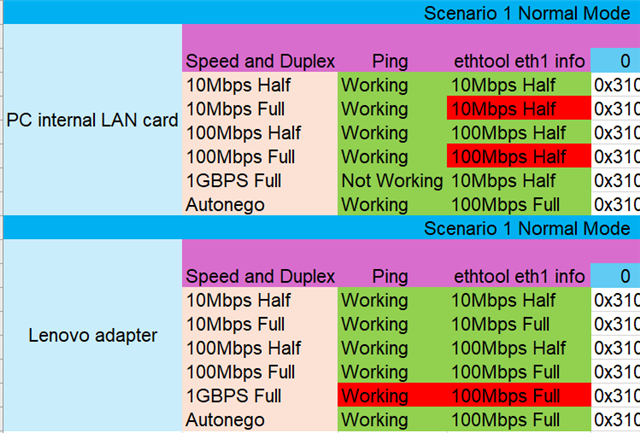

    Kindly review the attached data and share your feedback or suggestions.TiSpeedDuplexingData.xlsx

    while investigating on issue related to speed configuration in the emac_adjust_link() function within the prueth_core.c file. During testing with a 1Gbps link, I observed that the function is initially entering the default condition where speed is not detected. However, it subsequently transitions to a 100Mbps full-duplex mode unexpectedly.
    To address this, I modified the default condition to set the speed to 10Mbps half-duplex. Despite this change, the system still switches to 100Mbps full-duplex. Below is the relevant code snippet:

  • Hello Bhavya,
    Apologies for the delayed responses from this end, I had a death in the family a few days ago. I will be taking additional time off on Friday and Monday.
    AM437x PRU Ethernet on Linux SDK 8.2 only support 100M FD.
    If you want gigabit link speed, you would need to use the CPSW interface instead. The PRU-ICSS on AM437x is limited to 100M link speeds (though the PRU_ICSSG on devices like AM64x can go up to gigabit speeds).
    PRU Ethernet support was dropped in AM437x SDKs 9.1 & 9.3, but we are re-adding support for PRU Ethernet in the upcoming AM437x SDK 11.1 (Linux kernel 6.12). I have been told that they are adding support for 10M FD and HD, and 100M HD. I am asking for confirmation that these other speeds have been tested.
    Nick
  • Hello Bhavya,
    Summary - please run link speed tests with a Linux link partner, not Windows
    As per our offline discussion, you were seeing links established at unexpected frequencies and duplexes when the AM437x was set to autonegotiate, and when the link partner was set to a specific frequency:
    However, you were using a GUI interface on a Windows computer to set the link speed, and there was no way for you to actually see the settings take effect on the Windows side.
    I suspect that Windows was "lying" to you. Please use a link partner running Linux (for example, a computer running Ubuntu, or another AMxx Linux board). That way you can actually verify your link settings, and see your statistics from the partner side with ethtool:
    * verify that you are at the speed and duplex that you expect
    * link status should be yes
    * should see both TX and RX packets
    Why do I think these tests are not valid?
    The PHYs negotiate a link speed between the 2 PHYs. So if the MAC could only interact with the PHY at a fixed link setting (e.g., 10M HD), then the OS needs to tell the PHY what the allowable link speeds are. If the link cannot be set up at one of the allowable link speeds, then I would expect to see that the link fails to be established. Pings should be impossible.
    Let's look at the 1Gbps full duplex usecase. Let's pretend that something got messed up between the Windows MAC and the PHY, and the PHY was allowed to establish a 100Mbps full duplex link even though the MAC was in a fixed 1Gbps link. What would happen?
    The MAC which is set to fixed link mode will generate a TX_CLK and TX data at 1G rates. And the PHY would set the RX_CLK and RX data to be at 100M rates. Then the MAC and the PHY would fail to talk to each other. A ping should be impossible.
    As far as I can tell, AM437x seems to be behaving as expected here with the autonegotiate settings. If the link partner is the one enforcing a lower or higher link speed, then it is probably the link partner who is misbehaving when a different link speed is established.
    Nick
  • Hi Nick,
    Thank you for your prompt response.
    I had also suspected that my Windows system might not be performing as expected, which led me to conduct further testing using a standard managed switch. The results clearly show consistent behavior across different setups—whether using a PC-attached LAN card, a Linux system with an external adapter and auto-negotiation disabled, or a managed switch.
    Following the recent changes made to the DTS file, I’ve noticed a shift in behavior as previously described. I would appreciate it if you could kindly review the DTS modifications and confirm whether they are correct.
    Additionally, I’ve shared my observations over email regarding IEEE standard compliance. I would be grateful if you could verify those findings, as the results obtained on the Linux system align with them.
    One specific point to highlight:
    • When executing the command ethtool -s eth0 speed 1000 duplex full autoneg on, the device does not fall back to 100 Mbps Full Duplex.
    • However, when using ethtool -s eth0 autoneg on, the device does fall back to 100 Mbps Full Duplex as expected.
    Other than this, everything appears to be functioning correctly.
    Please find the attached data for your convivence I have also shared the same excel in the mail.
    Scenario 1 Autoneg Off command :  ethtool -s eth0 speed xx duplex xx autoneg off
    Lenovo adapter with Linux System Speed and Duplex Ping  ethtool eth1 info Internal Register values
    0 1 4 5 0x10 0x467 0x468
    10Mbps Half Working 10Mbps Half 0x3100 0x786d 0x01e1 0x0021 0x0913 0xffea 0xffea
    10Mbps Full Working 10Mbps Half 0x3100 0x786d 0x01e1 0x0021 0x0913 0xffea 0xffea
    100Mbps Half Working 100Mbps Half 0x3100 0x786d 0x01e1 0x0081 0x0f11 0xffea 0xffea
    100Mbps Full Working 100Mbps Half 0x3100 0x786d 0x01e1 0x0081 0x0f11 0xffea 0xffea
    1GBPS Full Not Working 10Mbps Half 0x3100 0x7849 0x01e1 0x0000 0x4902 0xffea 0xffea
    Scenario 1 Autoneg Off command :  ethtool -s eth0 speed xx duplex xx autoneg on
    10Mbps Half Working 10Mbps Half 0x3100 0x786d 0x01e1 0x4c21 0x0913 0xffea 0xffea
    10Mbps Full Working 10Mbps Full 0x3100 0x786d 0x01e1 0x4c41 0x4917 0xffea 0xffea
    100Mbps Half Working 100Mbps Half 0x3100 0x786d 0x01e1 0x4c81 0x4f11 0xffea 0xffea
    100Mbps Full Working 100Mbps Full 0x3100 0x786d 0x01e1 0x4d01 0x4f15 0xffea 0xffea

    Scenario 1
    Scalance XC206-2 Managed switch Speed and Duplex Ping  ethtool eth1 info Internal Register values
    Autonego Working 100Mbps Full 0x3100 0x786d 0x01e1 0xcde1 0x0f15 0xffea 0xffea
    Looking forward to your confirmation and feedback.
    Bhavya
  • Hello Bhavya,
    Is this command the command that you are running on the Linux system, or on the AM437x board? Please provide the commands that are used on both sides of the link.
    Nick
  • Hi Nick,
    I have provided this command over the Linux system. I am having linux PC through which I gave following commands
    same I have mentioned in the top column of the results. (such as Scenario 1 Autoneg Off command :  ethtool -s eth0 speed xx duplex xx autoneg on). If you have any other doubt than do let me know.
    Bhavya
  • Hi Nick,
    in the device side I will be keeping it in auto negotiation mode only there won't be any change from the device end. So from device end I am not giving any command. I am only giving command from the linux system which has been mentioned earlier.
    Bhavya
