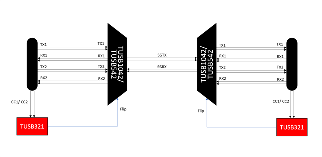

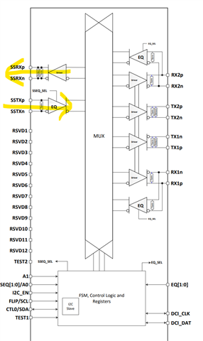

  • Hi Vishesh Pithadiya,
    Thanks. While using TUSB1042I, in the design block diagram you have shared we could see TX is connected to TX and RX to RX. Do we need TX to RX inversion? We will be using USBC receptacle on either side.
    Also, as per TUSB1042I datasheet SSTX and SSRX are for upstream facing port. In above diagram for the first TUSB1042I IC TX/RX is connected to the receptacle. Does this configuration work seamlessly?
    Do we need R-ESD series resistor on the superspeed lines for ESD compliance? Can it be added on the host facing superspeed lines?
    As per application diagram of TUSB1042I, 0.1uF is recommended on Tx line. Do we need to add any CAP on Rx line? Do we need capacitor on super speed lines between TUSB1042I?

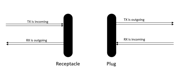

    The naming convention and data direction for a USB Type-C can be seen below:
    The TUSB1042 can be used in MUX and DEMUX applications. The EQ will be applied appropriately in both directions:
    The type-C end of the MUX will work seamlessly, but we will need to careful on the common side of the MUX. The data directions can be seen in the highlights. We need to make sure this is consistent with the USB-C receptacle at the common side.

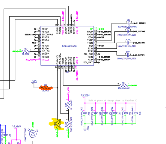

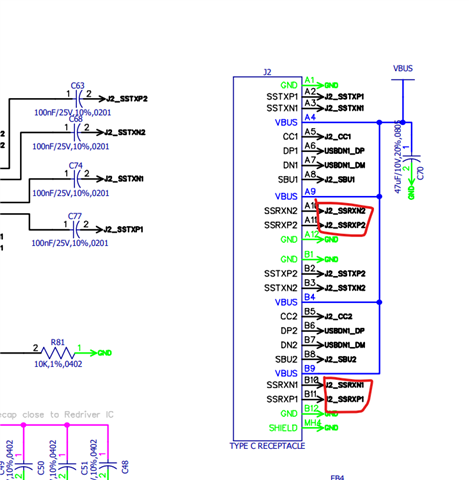

    Please share an updated schematic so I can review before going into layout/ fab.

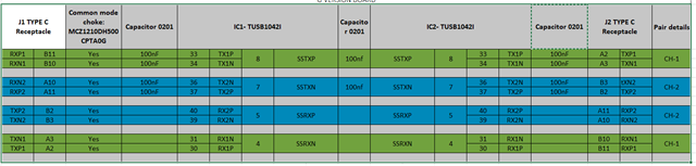

    Thanks for the detailed response. Please find the updated schematics and pin mapping image for your reference. Please do review and let us know your suggestions.
    TUSB1042 redriver for type c application.pdf
    I will review this and get back to you by Friday. I want to make sure we do everything correctly, so I will sped some extra time on this one.
    Let us know if you could review and if there are any comments on the schematics. Thanks.

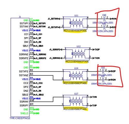

  • Hi Justin,
    Sorry for the delays. Here is the schematic review:
    1) Chnage the 100nF caps here to 330nF for the RX pins. Make sure the CMC has sufficient BW for USB 3.2 Gen 2.
    2) Need Ac coupling on the common RX path as well.
    3) Best to to have 100nF on TX lines and 330nF on the RX lines.
    4) Having the TUSB321 as DRP is correct. Flip pin is also routed correctly.

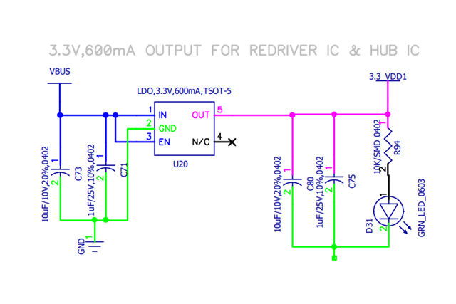

    5) Make sure LDO is sufficiently rated for Downstream Vbus as well.

    We have designed and tested above schematics. But unfortunately, USB3 enumeration is not at all working. Are there any specific check points or configurations we need to verify?
    Are we correct in connecting TX to RX and vice versa on the first receptacle (cable connecting to host)?
    Also, SSTX pins of both IC have connected each other. In EVAL board and every other application circuit we could see SSTX connected to host side? Can you check this once again?
    Thanks for your detailed debug steps. We could resolve the detection issue with following correction.
    1) Unlike TUSB1104, for TUSB1042I we have connected TX to TX and Rx to Rx without crossover.
    2) SSTX from 1st TUSB1042I IC we have connected to SSRX of 2nd TUSB1042I and vice versa.
    Both changes helped and we are able to FLIP the USB C cable on the host side. FLIP logic on the secondary (device) side is still not working (TUSB321 output is always HIGH). We have tested secondary TUSB321 in both DRP and DFP mode. Do you have any further suggestions?

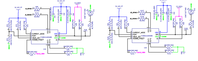

    If you do can you probe the CC1 and CC2 inputs of the TUSB321 that always has a high output. Id like to see the waveforms with and without a cable connected.

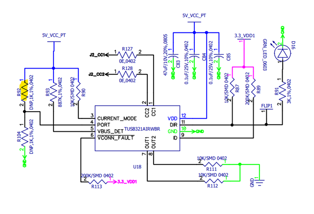

  • Which CC controller is having issues U16 or U18?
  • Yes we have 200MHz. We will monitor CC1 and CC2 pin and share you the details.
    U16 is working perfectly whereas U18 is having the issue.
  • Got it, Ill have another look at the schematic. Send the data once you have it ready. Thanks!
  • The schematics look the same to me, so I dont see why one works and the other doesn't. Try depopulating R109 here.
    R109 is not assembled in our PCB. We tried to bring up second PCB with same changes but unfortunately, we USB enumeration is still not working. We are figuring out what's the issue. Once this PCB is up and running (first PCB we had to give to another team for continuing rest of the development), we will be able to provide CC waveforms.

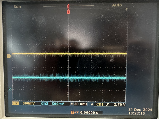

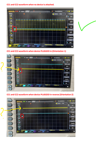

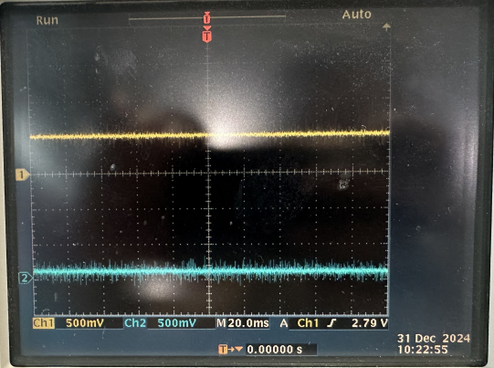

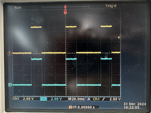

    We captured CC1 & CC2 of J2 connector. Please find the attachment for waveforms, when no device attached and with device attachment in both orientation.
    Waveforms.pdf
    Thanks for the waveforms. From what I see the waveforms looks correct when no device is plugged in. However, I'm not able to see what the voltage levels of  CC1 are as ground reference is not present in the scope captures.
  • I will take some captures using our TUSB321 EVM in lab and post them here for reference.
  • Sure. CC1 and CC2 are toggling between 5V and 1.8V.
  • Here are the waveforms i captured:
    1) No device plugged in
    2) Normal Orientation
    3) flipped orientation:
    Looks like the values for CC are too high in your system. Is it possible that this part was damaged?

    We've measured the CC1 and CC2 waveforms on the host side — both lines are toggling correctly between 0V and 1V depending on cable orientation, so the FLIP logic appears to be working as expected on this side.
    However, on the device side, CC1 and CC2 are toggling between 5V and 1.8V across multiple boards. Just to observe, we swapped the host USB to the original device side connector, and in this setup, both CC1 and CC2 lines toggle correctly between 0V and 1V based on cable orientation.
    Could there be an issue with the TUSB321 configuration on the device side?

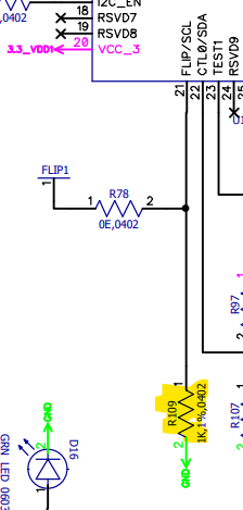

    I see that ESD diodes are only implemented on the host side, but not on the device side. Are we sure no ESD damage has taken place?
    What we can try is manually pulling down the FLIP pin on U15 so we will remain in normal orientation
    For this we will need to depopulate R78 and repopulate R109
    Then try both orientations of the device on the connector and see if we can enumerate.
    The CC waveforms seem incorrect, but as the port works with the host and not the device this is odd. One thing we can try is setting U18 as DFP rather than DRP forces this to be a downstream facing port.
    This is done by PUP the PORT pin
    Try measuring the CC waveforms after changing this.

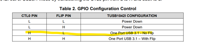

    There was no difference in behavior in either case. However, when we manually pull down the FLIP pin on the TUSB1042I, the setup works correctly, and the signal routing is as expected. This suggests that orientation detection may not be functioning properly under normal conditions.

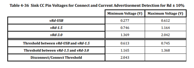

    Thanks for confirming. Yes, looks like this issue is stemming from incorrect settings of the FLIP pin. Now as we have confirmed that the routing can operate correctly. We will dig deeper into the CC controller as this seems to be the root cause.
    Now that the CC controller is disconnected from the FLIP pin of the TUSB1042, are we able to probe the DIR pin of the CC controller and make sure the setting is accurate for normal and flip orientations as per the datasheet.
    Additionally where are you probing the CC voltages. These values seem to high.
    These are the detecting tolerances for reference.
    CC1 is used for normal orientation and CC2 is used for flip orientation.
    When we see CC1 at 1.8V this means that a 5V 3A connection should take place, and this is what we see in all the experiments. However, the unused CC lines should be pulled down to ground when this takes place.
    Can you measure the CC voltages on U18 and U16 and see if the CC waveforms are as expected on U16?
    Yes, it is due to incorrect FLIP output from TUSB321AI IC. Like you said the voltage output is not as expected.
    CC voltage waveform is fine for U16 (toggling correctly between 0V and 1V depending on cable orientation) whereas U18 output is not of same as i mentioned earlier. We have measured this on R127, R128 resistor. But not sure what's the cause!
    The root cause is difficult to isolate as the schematic for both U16 and U18 are the same, but the performance of the chips are different. From what I see here, it looks as if U18 is damaged.
    Are you able to perform an ABA swap with this chip to see if the issue follows the the TUSB321 currently populated?
  • Got it, lets see the results from doing this.
    I'm still concerned with the odd CC waveforms, did you end up testing the ABA swap?
  • Yes, the issue persists on the same side even after swapping the IC. We suspect PCB /assembly related issues. Will verify it again on new PCB.
