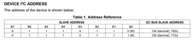

    The slave address of the TCA8424 itself is shown in table 1:
    This value is either 0x76 or 0x77. I don't see a linux command that shows that the customer is writing to the correct slave address. Is this captured in the I2C_detect or I2C_transfer function? I am not too familiar with how linux works.

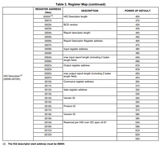

  • Hi Tyler,
    How can the HID descriptor be changed ?
    For example we have the HID descriptor length : 0x4041
    But the descriptor is just 0x001D .
    In general do we have any guidance on the steps that need to be performed to run TCA8424 as HID device?
    Alex

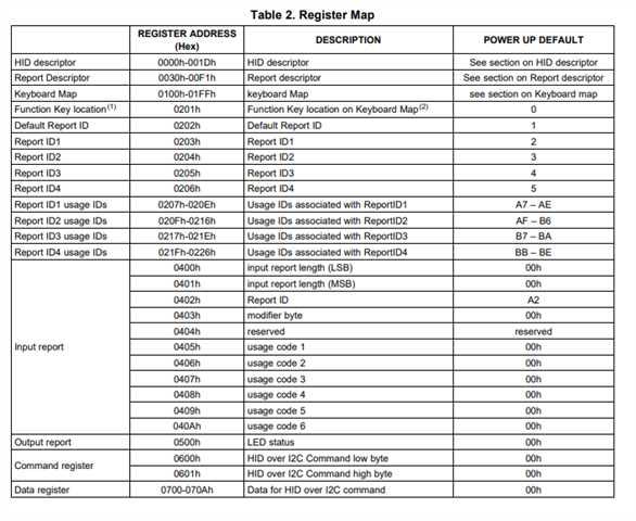

    Is there a reason that the HID Keyboard device always requires an I2C RE-start in between address and data communication ?
    You must first write the slave address (the address of the TCA8424) followed by register address according to the register mapping below:
    You write to a specific register address because you need to set the pointer address (point to the address you want to read from). After this, a repeated start condition occurs so that you can re-issue an I2C read command to read from the register address you selected.
    You write, repeated start, then read data from the register.
    Is there the possibility to exchange the Power UP default data with Valid data ?
    From my knowledge in the datasheet, it looks like all registers in table 2 accept both read and write commands.

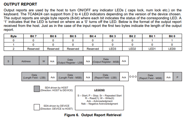

    You can follow the output report example for strictly writing data to a register address in table 2 to change the value of the register contents from its power up default value.
    Try following the output report format example, but when writing the register address - instead of writing to the output register, you would write to one of the register addresses in the HID descriptor: 0000h - 001Dh
    What commands were sent to determine the HID descriptor length of 0x4041?
    Tyler
  • Hi Tyler,
    This is achieved with the earlier described commands.
     0x41 0x42 0x43 0x44 0x45 0x46 0x47 0x48 0x49 0x4a 0x4b 0x4c 0x4d 0x4e 0x4f 0x50 0x51 0x52 0x53 0x54 0x55 0x56 0x57 0x58 0x59 0x5a 0x5b 0x5c 0x5d 0x5e
    is read from as first 30 bytes starting from address 0x0000.
