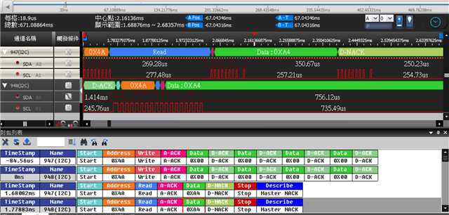

Hi Team,
Why can not read the second byte after first byte(0xA4) from Touch address 0x4A?
The 947 has send second clock but not repeat to 948 .
Finally, 948 disconnect and needs to reset 947 to reconnect.

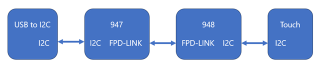

Here is the diagram of the application:
I2C Error frame:
