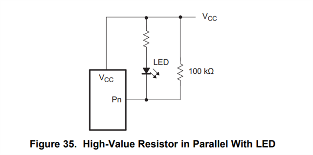

we use the TCA9555 design for LED application, there any issue with this schematic as below? could help double check it for us? thanks for your help and learn from you.

    TCA9555 IOL sinking current capability is up to 25 mA, with continuous abs. max current through ICC up to 160 mA.
    Current mA budget is 12 x 2.3 = 27.6 mA of LED current which TCA9555 can handle.

    The LED implementations on the Pxx pins use 100k external PU resistors to LED_VCC (i.e. R113). This will sink unnecessary current.
    TCA9555 already has internal 100k PU resistors built in on each I/O, see functional diagram below.

    If the device has a /INT pin and the /INT pin is used, tie this pin to a pull-up resistor.
     Good
    R263 - 10k PU to LED_VCC
    You are following the correct implementation in figure 35:
    But TCA9555 in particular has internal 100k PU resistors on each Pxx pin PU to VCC.
    If you decide to use the other I/O expander variant - TCA9535, then keeping the 100k PU resistors foot print would be best practice. TCA9535 is the same device as TCA9555, but with internal 100k PU resistors.

    About SDA and SCL pull-up resistors,
    The pullup resistors are present on host side in another schematic page. Its value is 1.5K for this I2C net, thanks.
  • Hi Tommy,
    That sounds like a good sized PU resistor for I2C applications. I have attached this application note if there is a further need/questions about PU resistor sizing.
