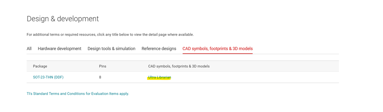

Do the altium component files exist?  I'd like a TI library if one is available.
  • Hi Max,
    For the component files we don't really have much to share on components that aren't made by us (which is basically everything on the board except the THVD8000 itself). You may be able to get the footprints/models for these parts on like Digikey or Mouser - I will include the EVM files (altium, gerbers, ODB,pick and place, and various pdfs of schematic/layout prints)  and BOM. Like I don't have a local copy of the models - everything is checked/in out of a main repository that I can't share.
    For the THVD8000 model you can go to the product page and scroll down to the design and development section and click the Ultra Librarian link - from there you will have multiple options to download the schematic symbol,  layout, and 3D models:
    This can be used for all of TI's parts - but what exactly is available may vary a bit.
