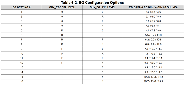

Hi. Are there recommended settings for the CHx_EQn strapping pins?
Part Number: SN75LVPE3101
This depends on the system losses. There is no one EQ setting for all applications, so we will have the tune the EQ for each application. What are the pre-channel (between SoC and redriver), and post-channel(between redriver and connector) losses?
