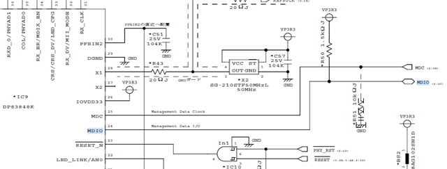

Hello.
I deverop our product implemented DP83848K.
It check Link Status register for Ethernet pysical connection.
If ethernet cable is connected, Link Status register is read of "Valid link established" always.
However, if ethernet cable is not connected, Link Status register is read of "Link not established" many,
But somtime read of  "Valid link established". Why?
Our software checks Link Status register every 150usec.
If ethernet cable is not connected, Link Status is read by the following ration.
 "Valid link established"(Error status) : "Link not established" = 1 time : 50-300 times
The read register is below.
Register address: 0x00 [bit 2]
Register name: Link Status
or
Register address: 0x10 [bit 0]

  • Hi Okazaki-san,
    Could you do a read on the device ID (register 0x02/0x03) before you do each read on the link status to ensure that the read on the link status is correct? We are wondering if the frequent read is causing the bus to mismatch the bit reads on the link status.

  • Hi J-san,
    Thank you very much for your reply.
    I confirmed rea value for device ID (register 0x02/0x03) .
    In case of success,
    PHY Identifier Register #1 = 0x2000
    PHY Identifier Register #2 = 0x5C90
    In case of failure,
    PHY Identifier Register #1 = 0xFFFF
    PHY Identifier Register #2 = 0x7FFF
    or
    or
    Do you have how to modification for always success?

  • Hi Okazaki-san,
    It looks like not every MDIO read is a success.
    Do you have a 1.5k to 2.2k pullup resistor on the MDIO line? MDIO bus requires this pullup for the bus to function normally.
    Could you also verify that your reads are within the setup/hold time violations below?

  • Hi J-san,
    My puroduct has 1.5k pullup resist on MDIO.
    Okazaki
  • Hi Okazaki-san,
    Is R51 populated? if so, could you try after depopulating this resistor?
