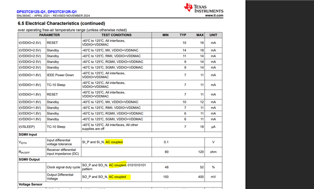

I would like to clarify the datasheet for this device.
For this PHY do AC coupling capacitors built in or need to be external? It's a little ambiguous in the datasheet.

Hi Vitaliy,
The ac-coupling caps needed are external. The conditions listed are the test conditions used for the measurement.
