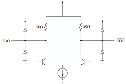

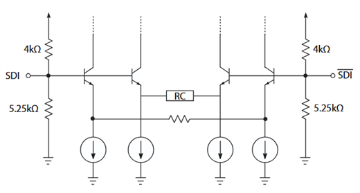

Dear Support,
Could you please provide me the input equivalent circuit (seen from IN0+/- and IN1+/-) and the output equivalent circuit (seen from OUT0+/- an OUT1+/-) of the LMH1219 ?
Something similar to the images below will be enough. The more detailed, the better.
Thank you,
Best regards
