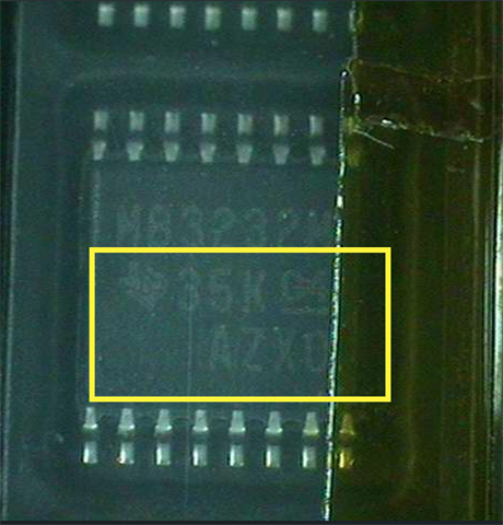

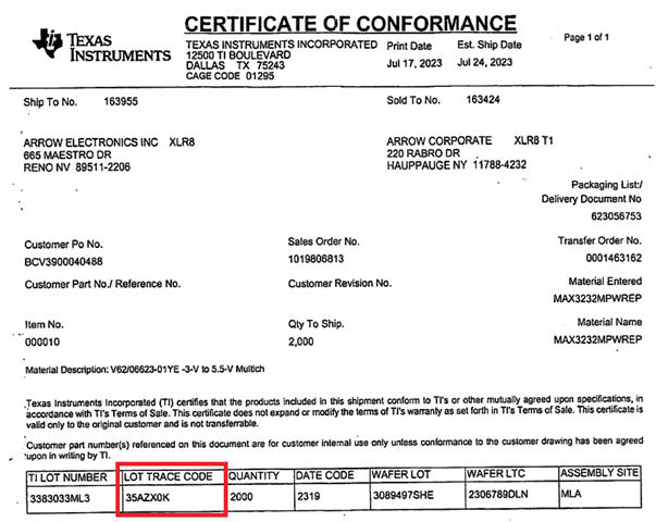

For PN# MAX3232MPWREP, we purchased through authorized distributor but trace code showing from TI's certificate does not match with actual marking.
On the actual part marking: 35KAZXO
On the TI certificate: 35AZX0K
As compared to certificate and actual marking, I can tell it has different sequence marked on the part.

  • 1) If trace code shown from actual marking and certificate are same
    They look at the same to me.

    For lot trace code for most packages (I think an exception for PDIPs) we use the date code from the first two from the second line then the 4 characters from the third row then back to the second row and take the assembly site code (yours is K).
    So lot trace code = 2 character date code from second row + third row 4 characters + assembly site from third character on second row
    your example = 35 + AZX0 + K
    35 = 2023 of 5th month (May)
    AZX0 = lot number
    K = assembly site (Malaysia)
    Not sure why TI does this but this is how we look up lot trace codes based on device top markings.
