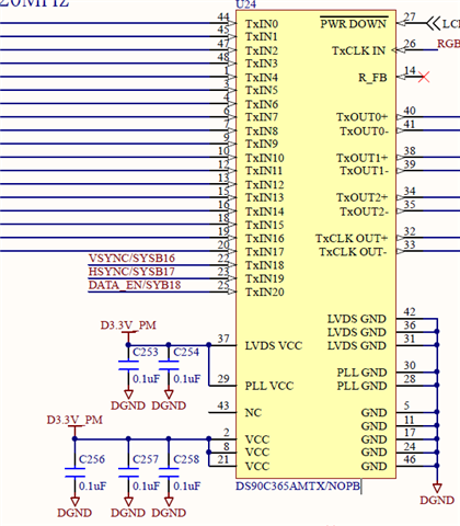

DS90C365A: Decoupling capacitor capacitance and layout
Part Number: DS90C365A
Please let me know if there are any specifications such as the number of decoupling capacitors, capacitance value, layout, etc.
For the time being, the current design is to install one 0.1uF (0603 meter) on each power pin (37pin, 29pin, 2pin, 8pin, 21pin).
The input side is RGB666 (21bit), and is planned to be used at 20MHz.
