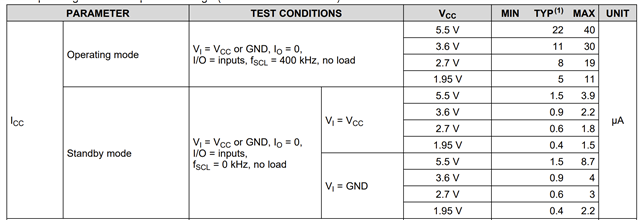

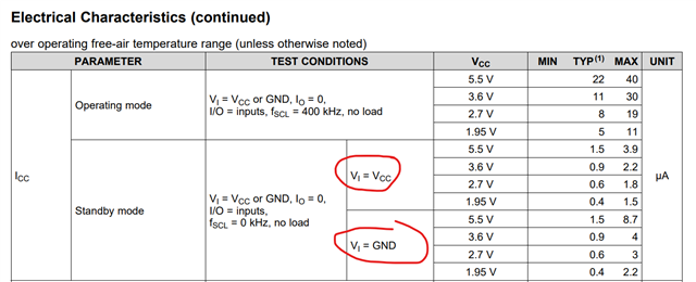

TCA9534: Does TCA9534 Have additional current consumption in standby mode?
Part Number: TCA9534
Other Parts Discussed in Thread: TCA6408A
I found out TCA6408A has  an additional current in standby mode of around 25uA. I could not find a parameter like this for TCA9534 . Does that mean it doesnt exist? I need it to be very Low Power
