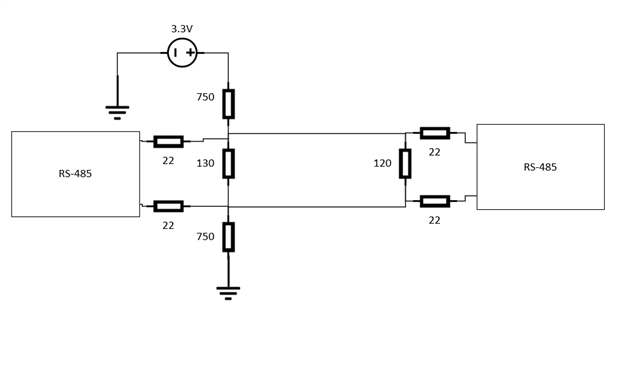

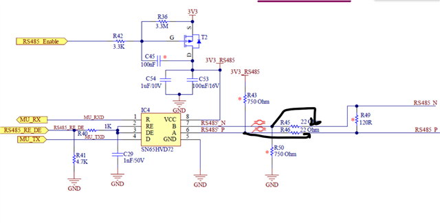

  • Hi Parker,
    Thanks for your detailed response
    I have few questions
    1.This is my final circuit which i would be using
    2.Do you see any challenge in any part of it?
    3.Trusting Failsafe Biasing Feature i have DNP R43 and R50 and 120 ohm as from my calculations my cable length is 2m and baud rate is 9600
    4.How did i calculate 750 ohm is i have issue of area on my pcb i need to choose 0402 package
    0.2=Vcc*Rt/Rt+2R where Vcc is 3.3 Rt is 120 ohm and 0.2 is difference i neeed between A and B
    So by that i get around 820 ohm
    Then i calculate I using 3.3/120+2(820) =1.87mA
    By this i can get difference between Va and Vb =1.824 -1.476 which is greater than 0.3V
    5.My question to you is did i do i properly or did i miss any part of calcualtion
    6.Even if i ignore 120 ohm my package of pull up and pull down would go high am i right?
    7.Decoupling my datasheet says 100nf i have added 1uF am i right doing it?
    8.I am enabling and disenabling my VCC line by a mosfet which would have minimum drop so that it doesnt affect my Vcc
  • Hi Harsh,
    Series Resistance Placement
    So in general - one note that I have right away is the placement of the fail-safe resistor pads w.r.t. series resistors.
    Essentially it should be:
    IC --> Series Resistors --> Fail-safe Resistor pads & Termination Resistor pad.
    Fail Safe Resistor Calculations
    As for the calculation of the fail-safe resistors:
    (All these calculations are found here: https://www.ti.com/lit/an/slyt324/slyt324.pdf?ts=1757001275138&ref_url=https%253A%252F%252Fwww.google.com%252F
    VAB = VS/((0.036 * RFS) - 1)
    Where RFS is your fail-safe resistor values (R43 and R50)
    Generally you would would pick VAB = 250mV (200mV for RS-485 compliant devices + 50mV margin)
    VS = 3.3V (the pull-up voltage)
    You have set RFS to 750 - this equation assumes that only one node has fail-safe resistors (only one node should have fail-safe resistors - the single pair will apply bias to the entire bus.
    VAB = 3.3/((0.036 * 750)-1) = 126.9mV
    So the current set up does add margin to the devices fail-safe (the device has integrated fail-safe so VID >= 0V is read as high - so a idle bias of 126.9mV will add margin to that - but this value isn't sufficient for classical RS-485 as idle VAB should be >= 200mV for classical RS-485).
    With a 3.3V supply you won't really be able to get 250mV bias voltage - but for this device that shouldn't be an issue as you don't even need the fail-safes (keeping the pads for them is still a good idea).
    So 750 ohms is fine for this device.
    You could try to lower it to get more bias - but that is unnecessary for this device.
    However if you want to max this out there is a check you can perform.
    You need to find RINEQ which is just equal to 1/(1/RCM - 1/RFS) where RCM = 375 ohms (from RS-485 standard) and RFS is the fail-safe resistor value.
    Next you would need to calculate how many unit loads the fail-safe network uses
    n = UL/RINEQ = 12k/RINEQ
    UL = one unit load = 12k
    Using your current setup:
    n = 12k/750 = 16 - so your current setup can handle up to 16 UL nodes - the current device you are using is 1/8th unit load so with 750 ohm resistors you could support 16*8 nodes - since you are only using 2 you should be good there.
    Other Schematic Concerns:
    1. You only need 100nF on the VCC pin - you don't need 1uF  - but I don't think it should cause too many issues to keep it - but it is not required.
    2. You can have the FET shutting on and off the device - but you need to ensure that the input voltage >= 3V and ensure VCC voltage isn't < 3V.
    3. If you are using UART typically the "R" pin is pulled up to VCC usually through a 1.5k resistor. It isn't a device issue - it is that many UART applications will have false start conditions if the "R" line isn't pulled high for idle conditions and the "R" pin is hi-z.
    4. If you have the fail-safe resistors installed - they should only be installed on one node.
    5. If you have the fail-safe resistors installed - the node with them installed the termination resistor cannot be 120 as the load impedance has changed for the load - you would need to use 130 ohms - please see below:
    Parker Dodson
