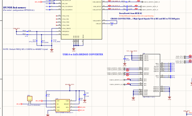

TUSB9261: Need to review the design of "TUSB9261IPAPQ1" interface with SSD
Part Number: TUSB9261
Dear Team,
Greetings from PHYTEC...!
I have attached interface design of "TUSB9261IPAPQ1" with SSD.
It would be great full if i get the review comments on the design.
09 USB_HUB EXTERNAL_SSD.pdf
Nikhil

  • Hi Nikhil,

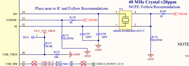

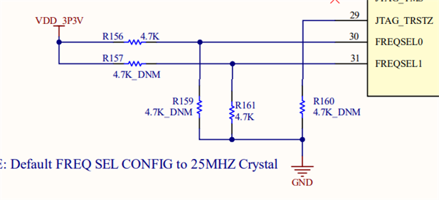

    It looks like the crystal you have selected is a 40MHz crystal. However, it looks like the FREQSEL pins are configured for a 25MHz crystal. The FREQSEL pins should both be pulled-up to 3.3V for a 40MHz crystal.
    For the RX lanes, 100nF caps are not needed. These should be removed.

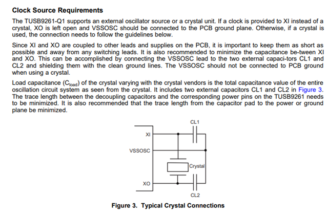

    Please ensure the crystal setup follows what is recommended in the datasheet:
    I.E, VSSOSC is not connected to PCB ground, and is used to ground the XI and XO capacitors. I would recommend connecting those capacitors to VSSOSC rather than PCB ground.
    I see you are using a type-C connector, but don't have a CC controller. Is this intended for a legacy-cable setup, like a type-A to a type-C, or for type-C to type-C? Typically, a type-C connector needs a CC controller to configure the devices role.
    Ryan

  • Hi Nikhil,
    I have modified as the changes and Type C connector CC pin we don't use it.
    Are you only using one side of the type-C connector? If so, then the type-C cable will not work for one flip orientation, and will only work in one specific orientation. And even then, a CC controller is still needed to communicate what the orientation of the cable is, so that the connection can take place.
