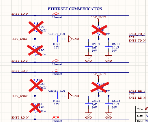

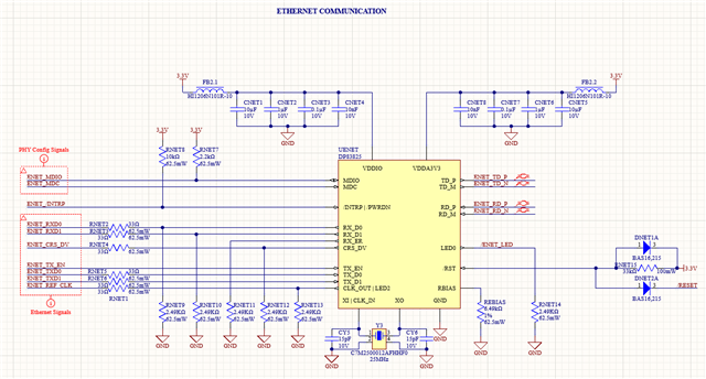

Please find in attachement, the schematics about the phy wiring :
(the crossed out components are not populated)

    LED0 auto-sets polarity based on the strapping. If the LED0 is pulled down at the power ramp, the LED0 will be active high and vice versa. It looks like the LED0 is pulled down in your schematic. This will cause the LED0 polarity to be active high instead of active low.

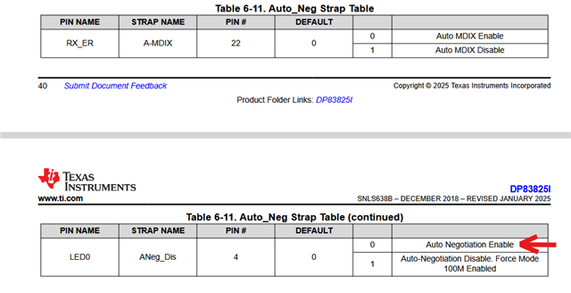

    Indeed, it seems it solved the LED problem (not the ethernet communication problem) but, in the datasheet, it is written in the Straps Configuration section that this pin is used to enable or not the auto negociation capability and not for the LED polarity, that is the reason why I soldered a pull-down resistor (now, the auto negociation capability will be enable by our program through the register writing).

  • Hi Benjamin,
    You are correct. However, the strapping also affects the LED0's polarity.
